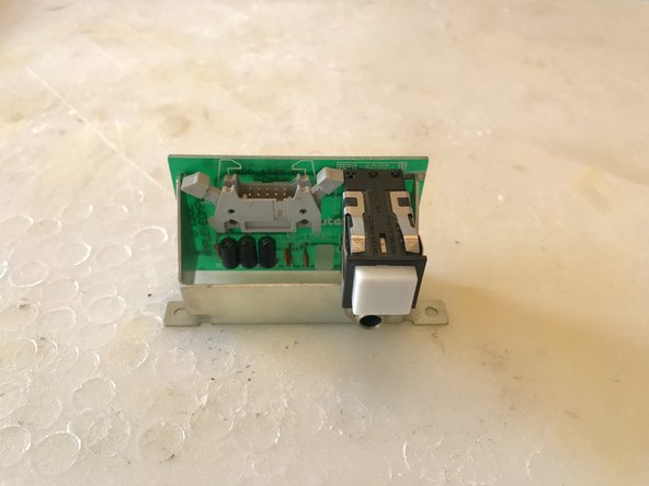

  1. Apple Lisa Soft Switch Lamp Replacement, Disassembly: crwdns2935265:01crwdnd2935265:01crwdnd2935265:01crwdne2935265:0
    • Follow the Apple Lisa disassembly guide steps 1-9.
  2. Apple Lisa Soft Switch Lamp Replacement, Remove Lamp Cover: crwdns2935265:02crwdnd2935265:01crwdnd2935265:03crwdne2935265:0 Apple Lisa Soft Switch Lamp Replacement, Remove Lamp Cover: crwdns2935265:02crwdnd2935265:02crwdnd2935265:03crwdne2935265:0 Apple Lisa Soft Switch Lamp Replacement, Remove Lamp Cover: crwdns2935265:02crwdnd2935265:03crwdnd2935265:03crwdne2935265:0
    • Insert something thin, non metallic, and sturdy. This will pop the the cover off the two clips that hold it in.
  3. Apple Lisa Soft Switch Lamp Replacement, Remove Bulb: crwdns2935265:03crwdnd2935265:01crwdnd2935265:01crwdne2935265:0
    • Be careful and remove old bulb with needle-nose pliers.
  4. Apple Lisa Soft Switch Lamp Replacement, Bulb Insertion: crwdns2935265:04crwdnd2935265:01crwdnd2935265:01crwdne2935265:0
    • When inserting the new bulb be careful to line up the prongs.
  5. Apple Lisa Soft Switch Lamp Replacement, Cover Replacement: crwdns2935265:05crwdnd2935265:01crwdnd2935265:02crwdne2935265:0 Apple Lisa Soft Switch Lamp Replacement, Cover Replacement: crwdns2935265:05crwdnd2935265:02crwdnd2935265:02crwdne2935265:0
    • The cover will have two small holes and two larger notches. The two smaller notches will go up and down and the larger notches go left and right.
  6. Apple Lisa Soft Switch Lamp Replacement, Reassemble: crwdns2935265:06crwdnd2935265:01crwdnd2935265:01crwdne2935265:0
    • Follow disassembly guide steps in reverse to reassemble.
