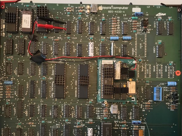

  5. Apple Lisa MacWorks II PFG Instalation, Installing the Daughter Board: crwdns2935265:05crwdnd2935265:01crwdnd2935265:01crwdne2935265:0
    • Ensure the pins on the MW+II PFG (Programable Frequency Generator) are perfectly straight. If they are not then slightly bend them into place.
    • Insert the PFG into the 8530 socket.

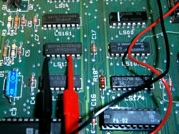

  6. Apple Lisa MacWorks II PFG Instalation, Attaching Red and Black Wires: crwdns2935265:06crwdnd2935265:01crwdnd2935265:03crwdne2935265:0 Apple Lisa MacWorks II PFG Instalation, Attaching Red and Black Wires: crwdns2935265:06crwdnd2935265:02crwdnd2935265:03crwdne2935265:0 Apple Lisa MacWorks II PFG Instalation, Attaching Red and Black Wires: crwdns2935265:06crwdnd2935265:03crwdnd2935265:03crwdne2935265:0
    • Locate the chip marked LS132 located at 6A.
    • Connect the Red and Black wires as shown in the second image on this step.
    • It is best to place a piece of electrical tape on the wires to help hold them in place.
  7. Apple Lisa MacWorks II PFG Instalation: crwdns2935265:07crwdnd2935265:01crwdnd2935265:01crwdne2935265:0
    • Replace the I/O Board back into Lisa's Card Cage.
    • Replace Lisa's Card Cage Back into the Lisa.
    • Replace the rear panel on the Lisa.
