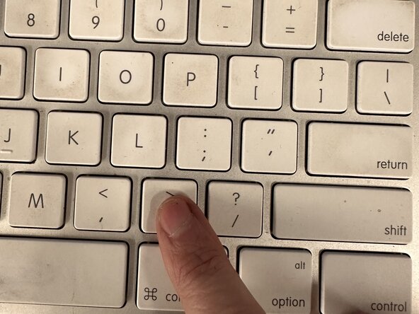

    • Place the keyboard on a flat surface.
  2. Apple Extended Keyboard A1243 Key Replacement: crwdns2935265:02crwdnd2935265:01crwdnd2935265:01crwdne2935265:0
    • Inspect the key that is stuck or the key mechanism where the missing key was.
  3. Apple Extended Keyboard A1243 Key Replacement: crwdns2935265:03crwdnd2935265:01crwdnd2935265:02crwdne2935265:0 Apple Extended Keyboard A1243 Key Replacement: crwdns2935265:03crwdnd2935265:02crwdnd2935265:02crwdne2935265:0
    • If the key is stuck, gently insert a spudger under the edge of the keycap.
    • Start from one corner and carefully pry the keycap from the keyboard, working your way around it until it pops out.

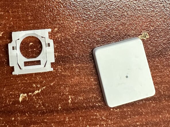

    • Inspect the key mechanism (scissor switch under the keycap) for any damage or debris.
    • If the keycap is dirty, clean it by soaking it in warm soapy water.
    • Ensure the key mechanism and cap are dry before reassembling.
  4. Apple Extended Keyboard A1243 Key Replacement: crwdns2935265:04crwdnd2935265:01crwdnd2935265:02crwdne2935265:0 Apple Extended Keyboard A1243 Key Replacement: crwdns2935265:04crwdnd2935265:02crwdnd2935265:02crwdne2935265:0
    • If the mechanism is damaged, you will need to replace it.
    • Install the new or previously removed key by aligning the keycap with the key mechanism. Align the top of the scissor-switch to the metal notches on the keyboard and then align the bottom of the switch, ensuring you hook the scissor-switch onto the metal tab on the keyboard.
    • Press down firmly on the keycap until it snaps into place.
