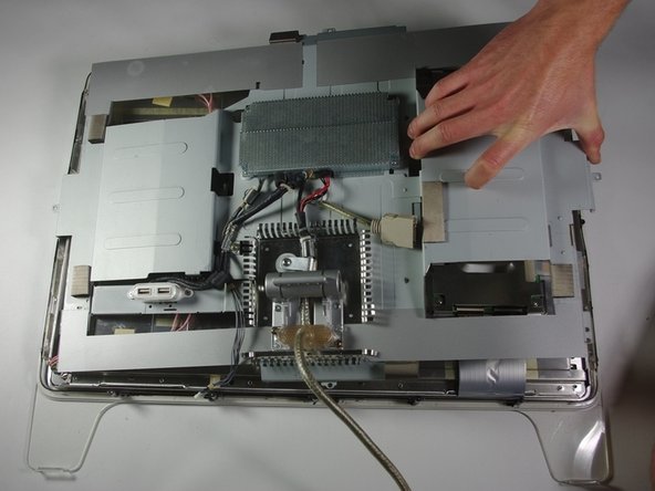

    4. Apple Cinema Display M8149 LCD Screen Replacement: crwdns2935265:04crwdnd2935265:01crwdnd2935265:03crwdne2935265:0 Apple Cinema Display M8149 LCD Screen Replacement: crwdns2935265:04crwdnd2935265:02crwdnd2935265:03crwdne2935265:0 Apple Cinema Display M8149 LCD Screen Replacement: crwdns2935265:04crwdnd2935265:03crwdnd2935265:03crwdne2935265:0
      • Unplug the large brown plug in the center-right, that connects the control board to the rest of the display.
      • Unplug the blue and gray plug on the right side of the control board. Repeat with the left side.

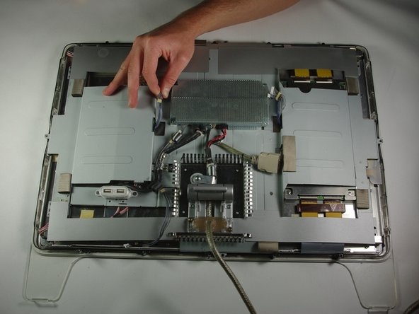

    5. Apple Cinema Display M8149 LCD Screen Replacement: crwdns2935265:05crwdnd2935265:01crwdnd2935265:02crwdne2935265:0 Apple Cinema Display M8149 LCD Screen Replacement: crwdns2935265:05crwdnd2935265:02crwdnd2935265:02crwdne2935265:0
      • Gently lift the large metal cover which spans across the back of the whole display.

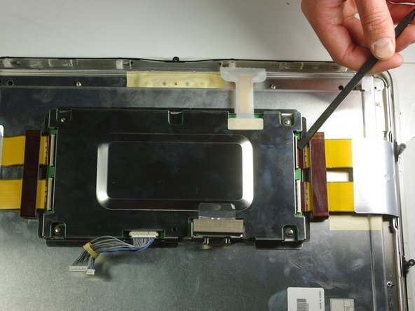

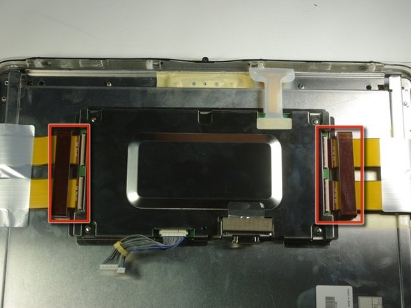

    1. Apple Cinema Display M8149 LCD Screen Replacement, LCD Control Board: crwdns2935265:06crwdnd2935265:01crwdnd2935265:03crwdne2935265:0 Apple Cinema Display M8149 LCD Screen Replacement, LCD Control Board: crwdns2935265:06crwdnd2935265:02crwdnd2935265:03crwdne2935265:0 Apple Cinema Display M8149 LCD Screen Replacement, LCD Control Board: crwdns2935265:06crwdnd2935265:03crwdnd2935265:03crwdne2935265:0
      • Carefully remove the two tape plugs on either side of the control board using a spudger.

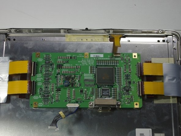

    2. Apple Cinema Display M8149 LCD Screen Replacement: crwdns2935265:07crwdnd2935265:01crwdnd2935265:03crwdne2935265:0 Apple Cinema Display M8149 LCD Screen Replacement: crwdns2935265:07crwdnd2935265:02crwdnd2935265:03crwdne2935265:0 Apple Cinema Display M8149 LCD Screen Replacement: crwdns2935265:07crwdnd2935265:03crwdnd2935265:03crwdne2935265:0
      • Pull the previously removed tape out from the metal box with your hand.
      • Peel back the white plastic cover located on the tape plug and unplug the tape plug on the right side of the unit using the spudger.

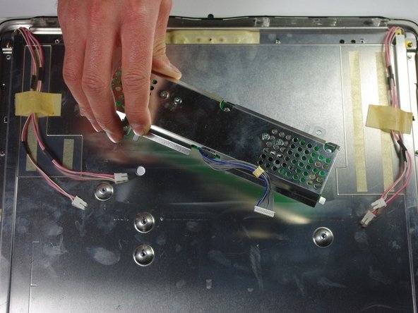

    3. Apple Cinema Display M8149 LCD Screen Replacement: crwdns2935265:08crwdnd2935265:01crwdnd2935265:03crwdne2935265:0 Apple Cinema Display M8149 LCD Screen Replacement: crwdns2935265:08crwdnd2935265:02crwdnd2935265:03crwdne2935265:0 Apple Cinema Display M8149 LCD Screen Replacement: crwdns2935265:08crwdnd2935265:03crwdnd2935265:03crwdne2935265:0
      • Unscrew the four screws (4.79x2.33mm) on the metal box using the Phillips #2 screwdriver.
      • Lift the metal cover off to reveal a circuit board.

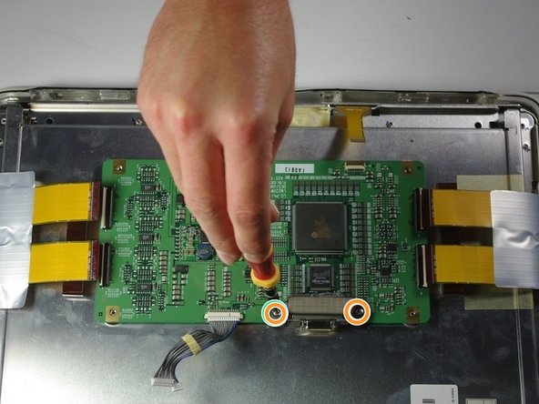

      • Remove the two terminal screws (4.79x2.34mm) using the Phillips #2 screwdriver.

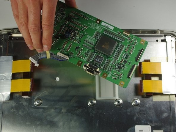

    4. Apple Cinema Display M8149 LCD Screen Replacement: crwdns2935265:09crwdnd2935265:01crwdnd2935265:02crwdne2935265:0 Apple Cinema Display M8149 LCD Screen Replacement: crwdns2935265:09crwdnd2935265:02crwdnd2935265:02crwdne2935265:0
      • Remove the terminal cover.
      • Remove the circuit board from the right side of the unit by gently lifting it out.

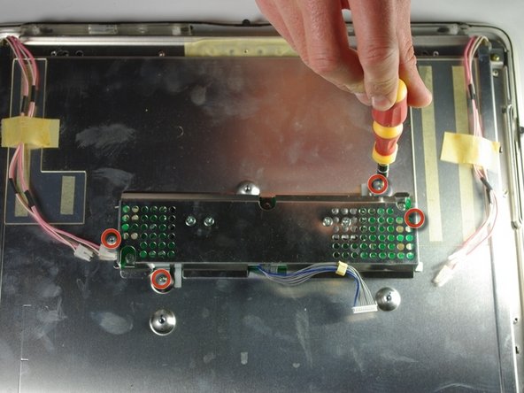

    1. Apple Cinema Display M8149 LCD Screen Replacement, Voltage Inverter: crwdns2935265:010crwdnd2935265:01crwdnd2935265:03crwdne2935265:0 Apple Cinema Display M8149 LCD Screen Replacement, Voltage Inverter: crwdns2935265:010crwdnd2935265:02crwdnd2935265:03crwdne2935265:0 Apple Cinema Display M8149 LCD Screen Replacement, Voltage Inverter: crwdns2935265:010crwdnd2935265:03crwdnd2935265:03crwdne2935265:0
      • Turn your attention to the left side of the cinema display.
      • Using your fingers, unplug the small white plugs with pink wires from the top and bottom of the circuit board.
      • Using the PH 2 screw driver, remove the four screws (6.9 x 2.55 mm) holding down the circuit board.
      • Remove the circuit board by gently lifting it from the display.

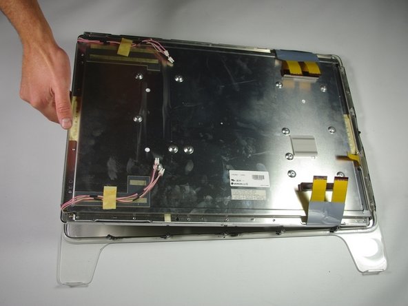

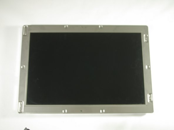

    1. Apple Cinema Display M8149 LCD Screen Replacement, LCD Screen: crwdns2935265:011crwdnd2935265:01crwdnd2935265:03crwdne2935265:0 Apple Cinema Display M8149 LCD Screen Replacement, LCD Screen: crwdns2935265:011crwdnd2935265:02crwdnd2935265:03crwdne2935265:0 Apple Cinema Display M8149 LCD Screen Replacement, LCD Screen: crwdns2935265:011crwdnd2935265:03crwdnd2935265:03crwdne2935265:0
      • Lift the screen from the surrounding front cover by sliding your fingers between the two pieces and lifting.
