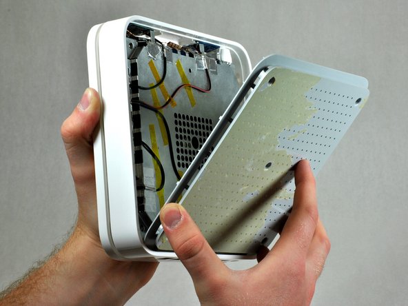

  1. Apple Airport Extreme Model A1408 Logic Board Replacement, Back Pad: crwdns2935265:01crwdnd2935265:01crwdnd2935265:01crwdne2935265:0
    • CAUTION: The heat gun and hair dryer can get very hot. Do not put your hands or any other body part too close to either device. Also, do not touch the back pad right after heating it.
    • Use a blow dryer or heat gun on a medium to high heat setting on the back pad to loosen the glue that attaches it to the device.
  2. Apple Airport Extreme Model A1408 Logic Board Replacement: crwdns2935265:02crwdnd2935265:01crwdnd2935265:01crwdne2935265:0
    • To avoid ripping the back pad, gently peel it back from one corner until the pad is completely off.
    • Use heat in areas where the glue is not loose enough.
    • You may need to reattach the back pad with double-sided tape if the glue is not tacky enough to stick the pad back on.

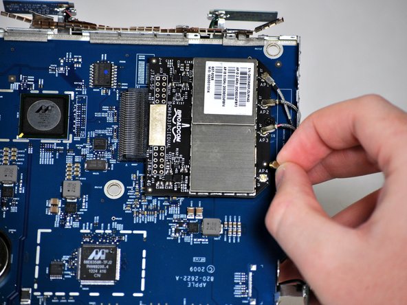

  5. Apple Airport Extreme Model A1408 Logic Board Replacement, Logic Board: crwdns2935265:05crwdnd2935265:01crwdnd2935265:02crwdne2935265:0 Apple Airport Extreme Model A1408 Logic Board Replacement, Logic Board: crwdns2935265:05crwdnd2935265:02crwdnd2935265:02crwdne2935265:0
    • Remove the four wires coming from the antennas by pinching the cable at the tip and gently pulling up on it until it pops out of the socket.
    • Repeat for the remaining three wires.
    • You might need to wiggle the wire to free it from the socket.

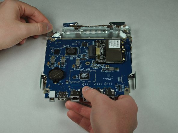

  6. Apple Airport Extreme Model A1408 Logic Board Replacement: crwdns2935265:06crwdnd2935265:01crwdnd2935265:02crwdne2935265:0 Apple Airport Extreme Model A1408 Logic Board Replacement: crwdns2935265:06crwdnd2935265:02crwdnd2935265:02crwdne2935265:0
    • Separate the logic board from the inner metal casing by gently pushing up on the logic board from the bottom while holding down the casing edges.
    • Pull the logic board away from the metal casing to separate the two.
