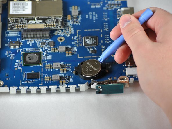

  5. Apple Airport Extreme Model A1408 Battery Replacement, Battery: crwdns2935265:05crwdnd2935265:01crwdnd2935265:02crwdne2935265:0 Apple Airport Extreme Model A1408 Battery Replacement, Battery: crwdns2935265:05crwdnd2935265:02crwdnd2935265:02crwdne2935265:0
    • Wedge the tip of a plastic opening tool between the battery and the securing clip. Pop the battery out using sufficient leverage.

Just Wondering, What is the Nomenclature , size and or specs of the internal battery A-1408 5th Generation have tried to find schematics to order a new
One but no dice. Bye the way you guys rock thank you so much, you may
E-Mail me at jcp512644@gmail.com
Jahn Peltz - crwdns2934203:0crwdne2934203:0
The battery is BR2330 3V. That is 23mm diameter and 3mm thickness.
