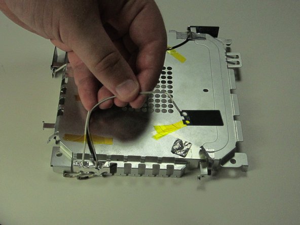

  8. Apple AirPort Extreme Model A1143 Wi-Fi Antenna Replacement, Wi-Fi Antenna: crwdns2935265:08crwdnd2935265:01crwdnd2935265:01crwdne2935265:0
    • Unscrew the 5mm #00 screws from each of the three antennas located on the sides of the metal casing.
    • Pull away antennas from metal case.
  9. Apple AirPort Extreme Model A1143 Wi-Fi Antenna Replacement: crwdns2935265:09crwdnd2935265:01crwdnd2935265:02crwdne2935265:0 Apple AirPort Extreme Model A1143 Wi-Fi Antenna Replacement: crwdns2935265:09crwdnd2935265:02crwdnd2935265:02crwdne2935265:0
    • Pull up the less visible silver tape that holds the antenna cords in place at the ends of the device using your fingers.
    • Remove clear yellow tape that holds the cords to the outer casing in the same manner.
