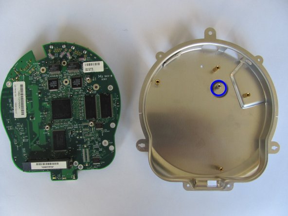

    • Locate and remove the five 7.5mm phillips screws from the motherboard.
    • Lift and separate the motherboard from the bottom metal casing.
    • There will be a loose hexagonal female screw extender under the motherboard.

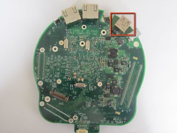

  9. Apple AirPort Extreme Model A1034 USB Port Replacement, USB Port: crwdns2935265:09crwdnd2935265:01crwdnd2935265:02crwdne2935265:0 Apple AirPort Extreme Model A1034 USB Port Replacement, USB Port: crwdns2935265:09crwdnd2935265:02crwdnd2935265:02crwdne2935265:0
