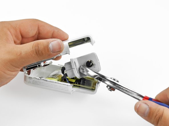

  4. Apple AirPort Express Base Station Power Supply Kit: crwdns2935265:04crwdnd2935265:01crwdnd2935265:02crwdne2935265:0 Apple AirPort Express Base Station Power Supply Kit: crwdns2935265:04crwdnd2935265:02crwdnd2935265:02crwdne2935265:0
    • Remove the grey power inlet from the case half it is still attached to. Use a pair of pliers to rock the power inlet back and forth until it breaks free from the glue.
    • Finish separating the case halves.

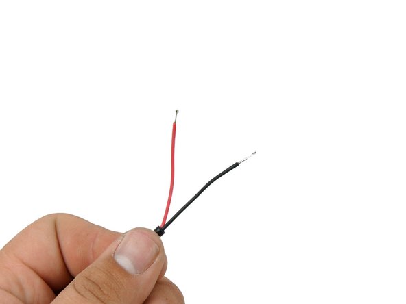

  17. Apple AirPort Express Base Station Power Supply Kit: crwdns2935265:017crwdnd2935265:01crwdnd2935265:03crwdne2935265:0 Apple AirPort Express Base Station Power Supply Kit: crwdns2935265:017crwdnd2935265:02crwdnd2935265:03crwdne2935265:0 Apple AirPort Express Base Station Power Supply Kit: crwdns2935265:017crwdnd2935265:03crwdnd2935265:03crwdne2935265:0
    • Cut the lead off of the power supply included in the kit.
    • You can cut the power supply leads as short as you desire to reduce clutter.
    • Strip the outer sheath off the wires. You can use either wire strippers with the correct size hole, or you can use a pair of wire cutters to carefully cut just the outer sheath.
  18. Apple AirPort Express Base Station Power Supply Kit: crwdns2935265:018crwdnd2935265:01crwdnd2935265:02crwdne2935265:0 Apple AirPort Express Base Station Power Supply Kit: crwdns2935265:018crwdnd2935265:02crwdnd2935265:02crwdne2935265:0
    • Strip approximately 7 mm of wire, being careful not to accidentally cut the wire.
