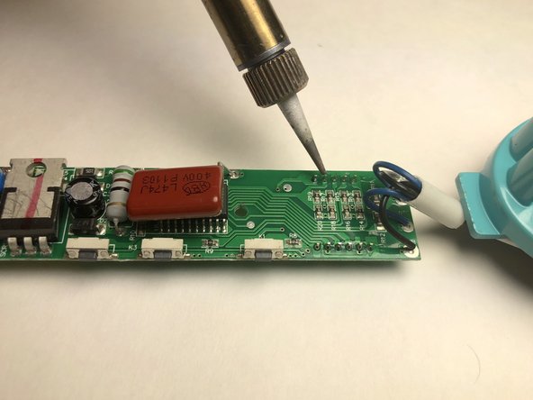

  5. Apalus Digital Hair Straightening Brush LCD Screen Replacement: crwdns2935265:05crwdnd2935265:01crwdnd2935265:01crwdne2935265:0
    • Locate the LED screen on the top side of the circuit board
  6. Apalus Digital Hair Straightening Brush LCD Screen Replacement: crwdns2935265:06crwdnd2935265:01crwdnd2935265:01crwdne2935265:0
    • Flip the circuit board to start soldering.
  7. Apalus Digital Hair Straightening Brush LCD Screen Replacement: crwdns2935265:07crwdnd2935265:01crwdnd2935265:02crwdne2935265:0 Apalus Digital Hair Straightening Brush LCD Screen Replacement: crwdns2935265:07crwdnd2935265:02crwdnd2935265:02crwdne2935265:0
    • Using the soldering tool, melt the solder holding the LCD screen on the circuit board.
    • The screen is soldered in 11 places on the circuit board. Melt each of these points and remove the screen.
    • Soldering Technique Guide
  8. Apalus Digital Hair Straightening Brush LCD Screen Replacement: crwdns2935265:08crwdnd2935265:01crwdnd2935265:02crwdne2935265:0 Apalus Digital Hair Straightening Brush LCD Screen Replacement: crwdns2935265:08crwdnd2935265:02crwdnd2935265:02crwdne2935265:0
    • Now that the LCD screen is removed, use a soldering tool and solder to install the new screen on the circuit board.
    • Solder at the same 11 points where you previously melted to remove the screen.
