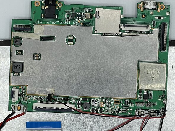

    • Turn off the device using the power button.
    • Using fingernails/a pry tool, separate the back panel of the device. This may require some force, as they are connected by push tabs.
    • Be careful not to drop the device when separating, as this could cause permanent damage.
    • This will expose the motherboard of the device.

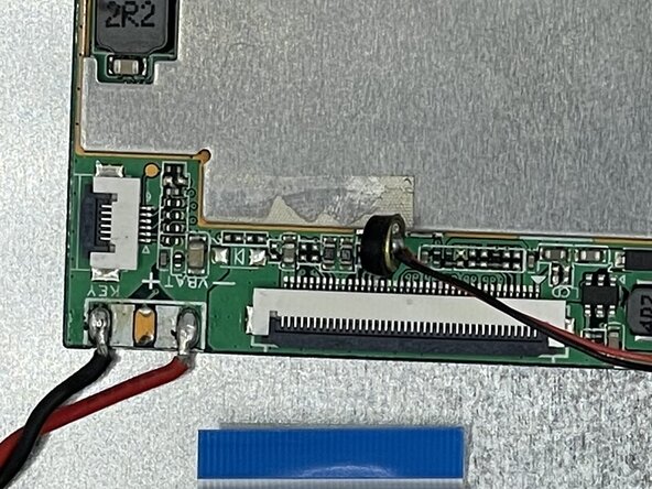

  2. Aoson R103 Speakers Replacement: crwdns2935265:02crwdnd2935265:01crwdnd2935265:02crwdne2935265:0 Aoson R103 Speakers Replacement: crwdns2935265:02crwdnd2935265:02crwdnd2935265:02crwdne2935265:0
    • Use your fingers to unclip the ribbon connector and then pull the ribbon out of the connector.
    • This ribbon connects the power button and stops the device from turning on.

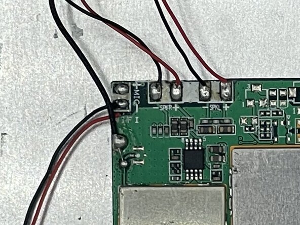

  3. Aoson R103 Speakers Replacement, Speakers: crwdns2935265:03crwdnd2935265:01crwdnd2935265:02crwdne2935265:0 Aoson R103 Speakers Replacement, Speakers: crwdns2935265:03crwdnd2935265:02crwdnd2935265:02crwdne2935265:0
    • These are the motherboard connections to the speaker, which will be needed later.
    • These are the two speakers, which are attached to a plastic piece via a screw.
    • Remove the 4.0mm long Phillips #00 screw where the plastic disconnects.
    • Be careful not to dislodge any of the wires behind the plastic piece when taking the plastic off.
  4. Aoson R103 Speakers Replacement: crwdns2935265:04crwdnd2935265:01crwdnd2935265:02crwdne2935265:0 Aoson R103 Speakers Replacement: crwdns2935265:04crwdnd2935265:02crwdnd2935265:02crwdne2935265:0
    • The box contains the four (4) soldering connections for the two speakers. Desolder the old speakers and solder the new speakers in.
    • Be sure to match up the appropriately placed speaker to its correct positive or negative node. Mixing these up could distort audio or fry the speakers.
    • Solder over a piece of paper where you can mark each node with a red marker to denote positive nodes and black marker to denote negative nodes for the left or right speaker.
