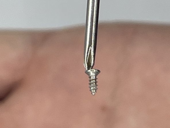

    • Locate the four (0.4 mm) screws positioned near the cameras at the top of the device, and use a screwdriver to unscrew them. (Circles).

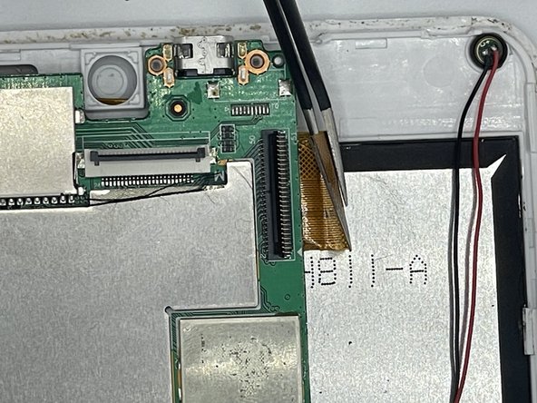

    • To disconnect the ribbon connectors, first, you need to flip up the tabs located above the ribbon gently. This will release the ribbon from the connector. Then, you can use tweezers to gently pull the ribbon out of the connector. Remember to be careful and avoid pulling too hard to prevent damage to the ribbon or connector.

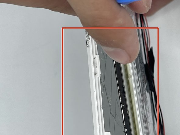

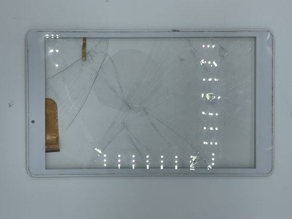

    • Remove the glass screen by unfastening all of the clasps located around the outer edge of the screen.
