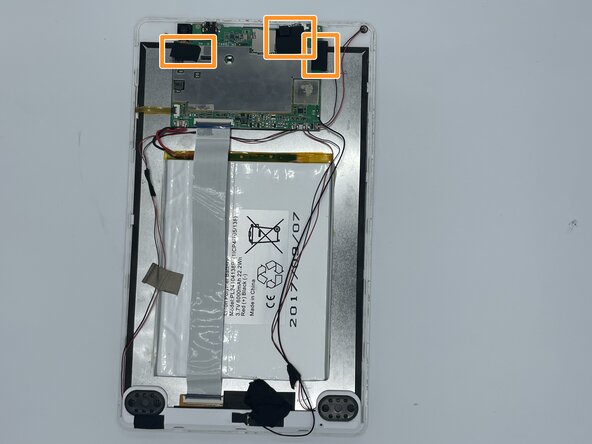

    • Turn your tablet on its side and get the iFixit opening tool.
    • Put the iFixit opening tool inside the edge of the tablet and lightly start prying along the back panel.
    • Open your tablet completely and lay it down on its screen.

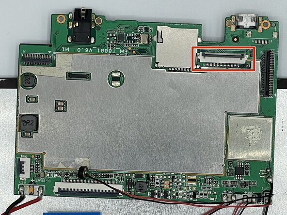

  2. Aoson R103 Device Page Front Camera Replacement: crwdns2935265:02crwdnd2935265:01crwdnd2935265:01crwdne2935265:0
    • Look at the motherboard located at the top of the tablet and remove the black tape from it.

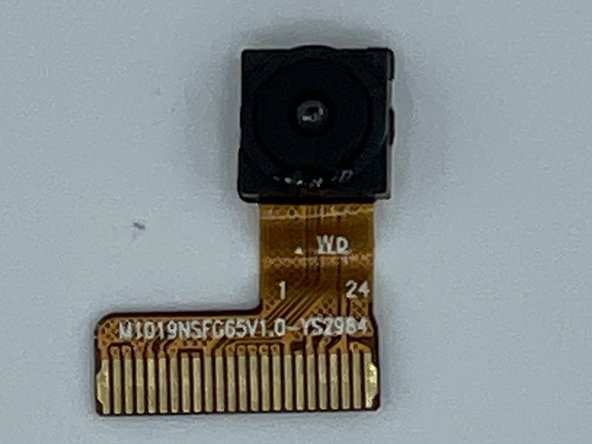

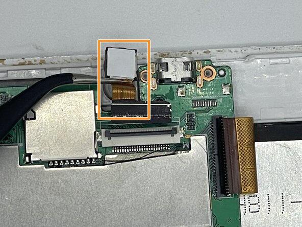

  3. Aoson R103 Device Page Front Camera Replacement: crwdns2935265:03crwdnd2935265:01crwdnd2935265:03crwdne2935265:0 Aoson R103 Device Page Front Camera Replacement: crwdns2935265:03crwdnd2935265:02crwdnd2935265:03crwdne2935265:0 Aoson R103 Device Page Front Camera Replacement: crwdns2935265:03crwdnd2935265:03crwdnd2935265:03crwdne2935265:0
    • Flip the tab up that is boxed with your fingernail or opening tool.
    • Use tweezers to pull out the band connected to the motherboard.
    • Pull the front camera out of the device with the tweezers.
