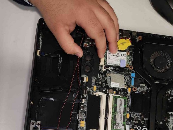

    • Flip the closed laptop over to access its underside.
    • Remove the twelve screws holding the back panel on.
    • Remove the back panel.
    • Locate the faulty speakers.
    • Remove the two screws from the speaker on the right side of the computer.
  2. Aorus X7 v2 Speaker Replacement: crwdns2935265:02crwdnd2935265:01crwdnd2935265:03crwdne2935265:0 Aorus X7 v2 Speaker Replacement: crwdns2935265:02crwdnd2935265:02crwdnd2935265:03crwdne2935265:0 Aorus X7 v2 Speaker Replacement: crwdns2935265:02crwdnd2935265:03crwdnd2935265:03crwdne2935265:0
    • Remove the three screws holding the left speaker in place.
    • Disconnect the left and right speaker plugs using the tweezers.

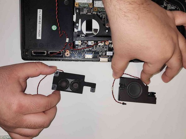

  3. Aorus X7 v2 Speaker Replacement: crwdns2935265:03crwdnd2935265:01crwdnd2935265:03crwdne2935265:0 Aorus X7 v2 Speaker Replacement: crwdns2935265:03crwdnd2935265:02crwdnd2935265:03crwdne2935265:0 Aorus X7 v2 Speaker Replacement: crwdns2935265:03crwdnd2935265:03crwdnd2935265:03crwdne2935265:0
    • Carefully lift up the left and right speakers to remove them from the motherboard.
