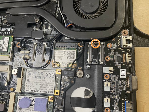

    • Use the Phillips #0 Screwdriver to remove the two screws holding the speaker in place. Lift off the speaker panel.
    • Use the Phillips #0 Screwdriver to remove the three screws holding the board in place.
    • Carefully pull the two black tabs on either side of the black ribbon to disconnect them from the board.

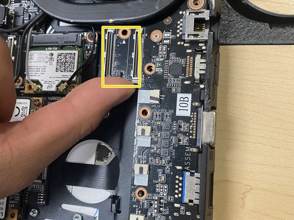

    • Gently pull off the inner black ribbon to remove it from the board.
    • Use the Phillips #0 Screwdriver to remove the screw.
    • Place a finger under the board (see photo for location reference) and slowly lift up to remove the board.
