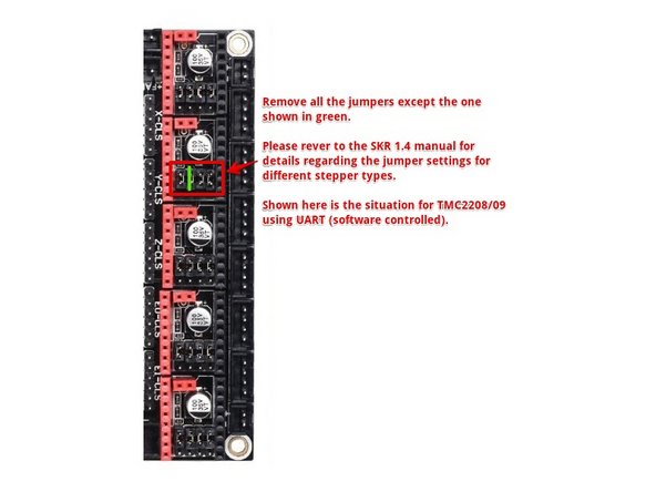

    • There's many options for stepper motor drivers. I've installed TMC2209s that were purchased with the board.
    • Make sure you print a support to hold the new motherboard. I haven't yet found a mount that takes the standoffs into account, but there are many options.
    • If you are installing the TMC2208/2209 drivers, then remove all the black jumpers located under the stepper driver sockets EXCEPT the one indicated in the diagram.

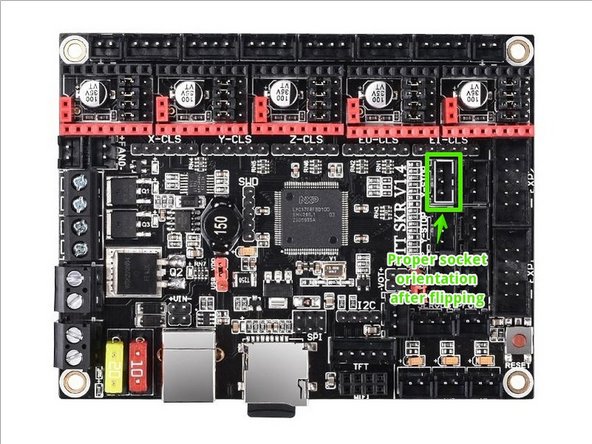

    • This step requires flipping the plastic socket around sets of pins. Be very careful and do this step slowly so that you don't break pins or break the sockets.
    • Take your needlenose pliers and slowly rock each socket back and forth, removing the socket from the board. The SKR has them installed the reverse that we need them, so we need to flip them 180 degrees from the stock installed direction.
    • Here is a gif of me flipping a socket on another board for reference: https://media.giphy.com/media/JonU7I9DJx...

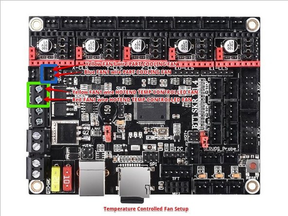

    • You have two options here. You can either let the software control the hotend fan, or leave it always on. There are benefits to both, and you can switch later on if you need to.

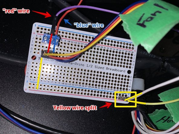

    • You will need to split the yellow wire coming from the FAN1 connector. I have done that using a small protoboard, but you can do that any number of ways.
    • To connect the part cooling fan you need to connect one line coming from the yellow FAN1 to the SKR FAN0 connector where marked. The blue FAN1 wire gets connected to the second SKR FAN0 pin. If possible, crimp them into a dupont/JST-SM connector to save yourself later.
    • If you are using the temperature-controlled hotend fan option (my recommendation using the stock hotends), then you connect one yellow FAN1 wire) to the HE1 connector where marked, and the red FAN1 wire to the other HE1 connector where marked.
    • If you are using the always-on hotend fan option (recommended if you're using all-metal heat break and upgraded hotends) then you connect one yellow FAN1 wire to the SKR FAN1 marked area, and connect the red FAN1 wire to the SKR FAN1 marked area.
    • The Anycubic fan system uses a single +24VDC common line (yellow wire on the original FAN1 connector). The GND is not a common GND on the fan plugs, so do not short the GNC lines on the fan plug. Only a single +24VDC is needed to power the fans as it is a common line for all fans.
