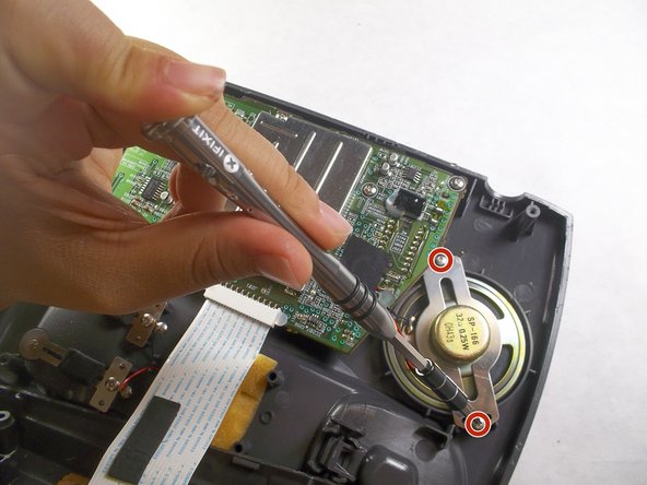

  3. Answering Machine Speaker Replacement, Answering Machine Speaker: crwdns2935265:03crwdnd2935265:01crwdnd2935265:02crwdne2935265:0 Answering Machine Speaker Replacement, Answering Machine Speaker: crwdns2935265:03crwdnd2935265:02crwdnd2935265:02crwdne2935265:0
    • Locate the speaker at the top left of the base as pictured. It is the silver, conical component. Two 7mm Phillips #0 screws hold the speaker in place.
    • Use a screwdriver to remove the two 7mm Phillips #0 screws.
  4. Answering Machine Speaker Replacement: crwdns2935265:04crwdnd2935265:01crwdnd2935265:01crwdne2935265:0
    • Finish speaker removal by cutting both the black and red wires.
