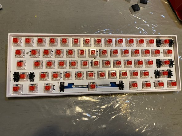

      • Set the keyboard down on a flat surface. Make sure it is turned off and is not connected to a power source.
    2. Anne Pro 2 Keyboard Keycaps Replacement: crwdns2935265:02crwdnd2935265:01crwdnd2935265:03crwdne2935265:0 Anne Pro 2 Keyboard Keycaps Replacement: crwdns2935265:02crwdnd2935265:02crwdnd2935265:03crwdne2935265:0 Anne Pro 2 Keyboard Keycaps Replacement: crwdns2935265:02crwdnd2935265:03crwdnd2935265:03crwdne2935265:0
      • Use the keycap remover to remove the key caps from left to right.
      • Remove the smaller keycaps first so the surrounding larger caps can be removed more easily.
    3. Anne Pro 2 Keyboard Keycaps Replacement: crwdns2935265:03crwdnd2935265:01crwdnd2935265:02crwdne2935265:0 Anne Pro 2 Keyboard Keycaps Replacement: crwdns2935265:03crwdnd2935265:02crwdnd2935265:02crwdne2935265:0
      • Use the compressed air to remove all dust and hair from the keyboard.
      • Focus on the red key switches to make sure all dust and hair are removed from inside.
    4. Anne Pro 2 Keyboard Keycaps Replacement: crwdns2935265:04crwdnd2935265:01crwdnd2935265:01crwdne2935265:0
      • New replacement keycaps can be used here, but if you see no damage to older keycaps they can be re-used.
      • Use the keycap remover to set in the keycaps starting from the bottom to the top.
    5. Anne Pro 2 Keyboard Keycaps Replacement: crwdns2935265:05crwdnd2935265:01crwdnd2935265:01crwdne2935265:0
      • Inspect the final product, making sure all keycaps are back in the right place and functioning.
