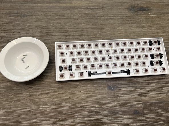

  3. Anne Pro 1 Mechanical Keyboard Switch Replacement, Screw Removal: crwdns2935265:03crwdnd2935265:01crwdnd2935265:03crwdne2935265:0 Anne Pro 1 Mechanical Keyboard Switch Replacement, Screw Removal: crwdns2935265:03crwdnd2935265:02crwdnd2935265:03crwdne2935265:0 Anne Pro 1 Mechanical Keyboard Switch Replacement, Screw Removal: crwdns2935265:03crwdnd2935265:03crwdnd2935265:03crwdne2935265:0
    • Locate and remove the five screws mounting the keyboard onto the keyboard case.
    • Secure the screws in a container for later use.

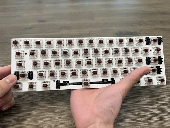

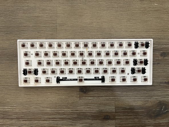

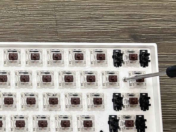

  4. Anne Pro 1 Mechanical Keyboard Switch Replacement, Removing keyboard plate: crwdns2935265:04crwdnd2935265:01crwdnd2935265:01crwdne2935265:0
    • With the screwdriver, carefully pry the keyboard plate out of the case from the spacebar gap located at the bottom of the plate.
    • This will require some force to pry open.

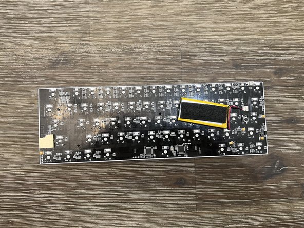

  5. Anne Pro 1 Mechanical Keyboard Switch Replacement, Removing the Keyboard Battery: crwdns2935265:05crwdnd2935265:01crwdnd2935265:01crwdne2935265:0
    • On the back of the keyboard plate you will find the PCB.
    • Carefully remove the battery attached to the PCB.
