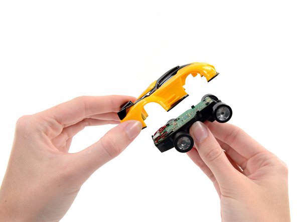

    • A single Phillips #0 screw secures the body to the chassis.
    • That means no adhesive, no security screws, and no complications of any kind to hinder chassis replacement.
    • We'll consider that an invitation to soup this bad boy up.

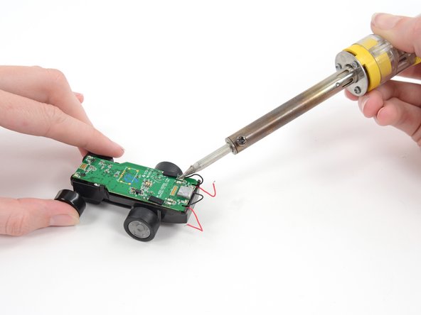

    • With all of the fancy processing tasks offloaded to your iDevice, the Anki car needs very little to survive in the wild.
    • After desoldering the dual motors' leads, the motherboard lifts easily out of the chassis, bringing all of the sensory, communication, and control circuitry out with it.
    • It even hosts two gear guides to keep the drive gears aligned to their motors, making this motherboard a true multitasker.

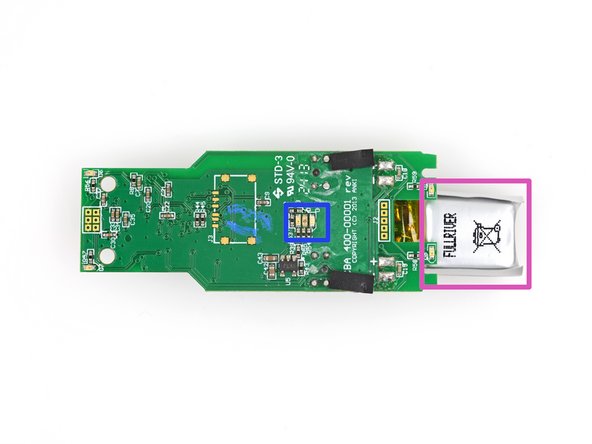

    • The front side of the motherboard:
    • STMicroelectronics F051K86 Entry-level ARM Cortex-M0 MCU with 64 Kbytes Flash, 48 MHz CPU, Motor Control and CEC Functions
    • Nordic Semiconductor NRF8001 Single-Chip Bluetooth Low Energy Connectivity IC
    • e160 317a
    • There are a few additional components on the board:
    • Imaging sensor
    • Four LEDs: one on the front side and a row of three on the back side
    • Fullriver 3.7 V lithium battery
  8. Anki Drive Teardown: crwdns2935265:09crwdnd2935265:01crwdnd2935265:03crwdne2935265:0 Anki Drive Teardown: crwdns2935265:09crwdnd2935265:02crwdnd2935265:03crwdne2935265:0 Anki Drive Teardown: crwdns2935265:09crwdnd2935265:03crwdnd2935265:03crwdne2935265:0

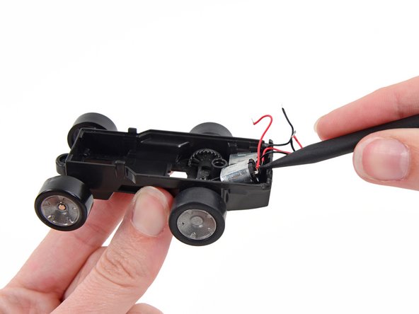

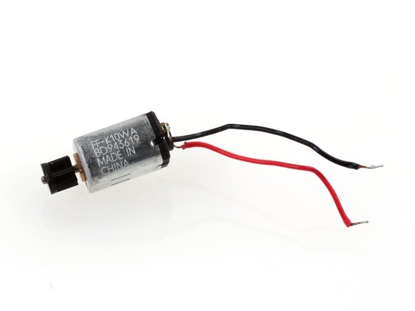

    • With the help of a spudger, we remove the motors from this zippy little guy, leaving him … unzipped.
    • Twin motors help the rear wheels do double duty, providing both propulsion and some surprisingly snappy steering.
    • With its motors hanging way out back of the rear axle, this little Ankimobile definitely hails from the controversial Porsche 911 school of car design.
    • The front wheels' only job is to not fall off. (It's always the little things.)

What capacity is the battery? Could it feasibly be swapped for one with more mAh to allow for longer play?
abimaelleon - crwdns2934203:0crwdne2934203:0
Today I determined they are 75mAh.
I asked myself the same question about increased capacity.
You can find the mini/micro equivalents on many sites (not necessarily Fullriver) but I cannot find a mini/micro of larger capacity.
In the first instance though I merely want to repair the cars that will no longer hold charge because they have not been used in a while.
giles -
