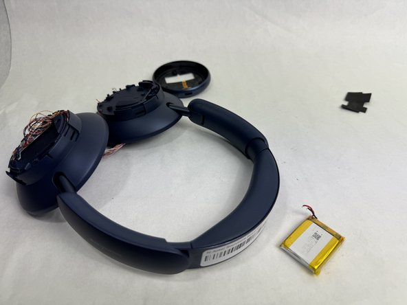

  3. Anker Soundcore Space Q45 Battery Replacement, Battery: crwdns2935265:03crwdnd2935265:01crwdnd2935265:02crwdne2935265:0 Anker Soundcore Space Q45 Battery Replacement, Battery: crwdns2935265:03crwdnd2935265:02crwdnd2935265:02crwdne2935265:0
    • Gently pull out battery to USB C ribbon connector from circuit board
  4. Anker Soundcore Space Q45 Battery Replacement: crwdns2935265:04crwdnd2935265:01crwdnd2935265:02crwdne2935265:0 Anker Soundcore Space Q45 Battery Replacement: crwdns2935265:04crwdnd2935265:02crwdnd2935265:02crwdne2935265:0
    • Pull directly up on the battery to release it from the tape holding it in place.
    • Battery terminals must be de-soldered to remove fully
    • Battery dimentions - 35mm x 25mm x 6mm 750-800mah 3.7v

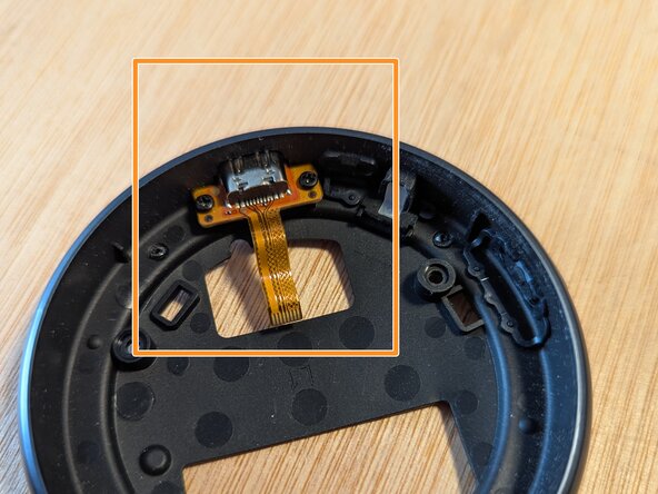

  5. Anker Soundcore Space Q45 Battery Replacement: crwdns2935265:06crwdnd2935265:01crwdnd2935265:01crwdne2935265:0
    • Replacing charging ribbon is tricky, use tweezers to reach through square hole and reconnect

Can you show a close up shot of battery? I want to identify its size and other specs...
Steven - crwdns2934203:0crwdne2934203:0
Look for a 632832, but you might have trouble acquiring a single unit, unless you're okay with waiting a month or two with aliexpress shipping
