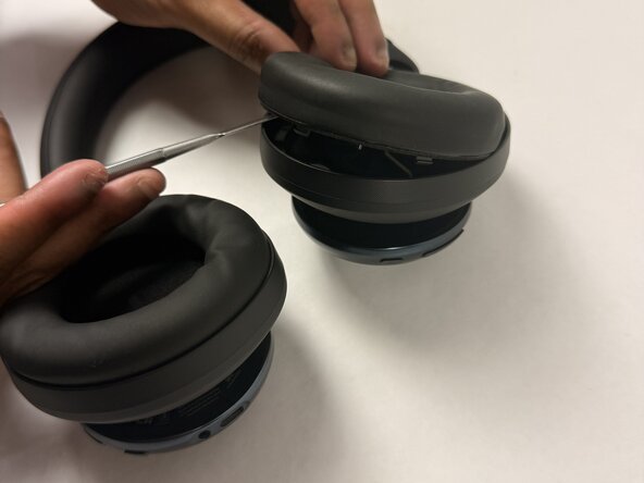

    • Flip over the device so the ear pads face up.
    • This replacement guide will only cover one of the ear pads. The same exact steps apply to both.
  2. Anker Soundcore Space One Ear Pad Replacement: crwdns2935265:02crwdnd2935265:01crwdnd2935265:02crwdne2935265:0 Anker Soundcore Space One Ear Pad Replacement: crwdns2935265:02crwdnd2935265:02crwdnd2935265:02crwdne2935265:0
    • Insert a spudger (plastic or metal) between the ear pad and the driver housing (the driver housing is the outside plastic part of ear cup).
    • Using a metal spudger (like the one pictured) can cut you if not used correctly. Please be mindful of where you insert it if you choose to use one.
    • Pry around the ear pad in a circular path until it fully releases.
  3. Anker Soundcore Space One Ear Pad Replacement: crwdns2935265:03crwdnd2935265:01crwdnd2935265:01crwdne2935265:0
    • Remove the ear pad from the driver housing.
    • The gray foam component shown is an additional protective component of the ear pad. You can remove it with your hands if needed, without any tools.
