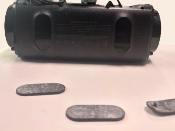

      • Use a spudger to remove each side speaker cover by inserting it in the crevice and using moderate force to pry them off.
    2. Anker Soundcore Select Pro A 3126 Button Panel Replacement: crwdns2935265:02crwdnd2935265:01crwdnd2935265:02crwdne2935265:0 Anker Soundcore Select Pro A 3126 Button Panel Replacement: crwdns2935265:02crwdnd2935265:02crwdnd2935265:02crwdne2935265:0

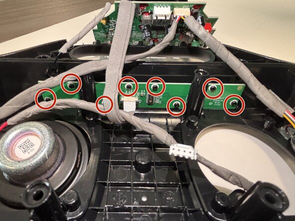

    8. Anker Soundcore Select Pro A 3126 Button Panel Replacement: crwdns2935265:08crwdnd2935265:01crwdnd2935265:01crwdne2935265:0
      • Use a Phillips #1 screwdriver to remove the eight 6.5 mm screws securing the button board.
    9. Anker Soundcore Select Pro A 3126 Button Panel Replacement: crwdns2935265:09crwdnd2935265:01crwdnd2935265:02crwdne2935265:0 Anker Soundcore Select Pro A 3126 Button Panel Replacement: crwdns2935265:09crwdnd2935265:02crwdnd2935265:02crwdne2935265:0
      • Use the tip of the spudger to push the black plastic locking tab away from the socket.
      • Pull the ribbon cable straight out of the socket.
      • Remove the old button board.
