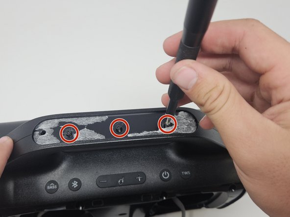

    • Tear off the padding on the top of the speaker with your hands.
    • Remove the three 15 mm screws located on the top of the speaker using a Phillips #1 screwdriver.

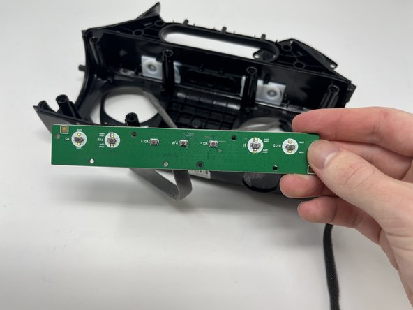

    • Orient your unit so that you can see the button board which is directly under the unit's handle.
  9. Anker Soundcore Motion Boom A3118 Button Board Replacement: crwdns2935265:09crwdnd2935265:01crwdnd2935265:02crwdne2935265:0 Anker Soundcore Motion Boom A3118 Button Board Replacement: crwdns2935265:09crwdnd2935265:02crwdnd2935265:02crwdne2935265:0
    • Remove eight 8 mm screws using a Phillips #00 screwdriver.
  10. Anker Soundcore Motion Boom A3118 Button Board Replacement: crwdns2935265:010crwdnd2935265:01crwdnd2935265:03crwdne2935265:0 Anker Soundcore Motion Boom A3118 Button Board Replacement: crwdns2935265:010crwdnd2935265:02crwdnd2935265:03crwdne2935265:0 Anker Soundcore Motion Boom A3118 Button Board Replacement: crwdns2935265:010crwdnd2935265:03crwdnd2935265:03crwdne2935265:0

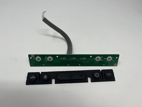

    • Slide the button board out and replace it with the new part.
