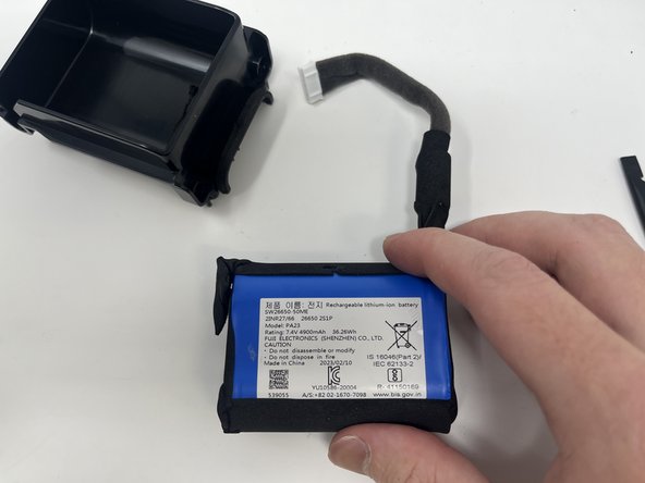

  12. Anker Soundcore Motion Boom A3118 Battery Replacement, Battery: crwdns2935265:012crwdnd2935265:01crwdnd2935265:02crwdne2935265:0 Anker Soundcore Motion Boom A3118 Battery Replacement, Battery: crwdns2935265:012crwdnd2935265:02crwdnd2935265:02crwdne2935265:0
    • Tear off the sticky padding from the battery.
    • The battery is now free and able to be replaced.
