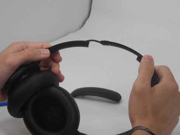

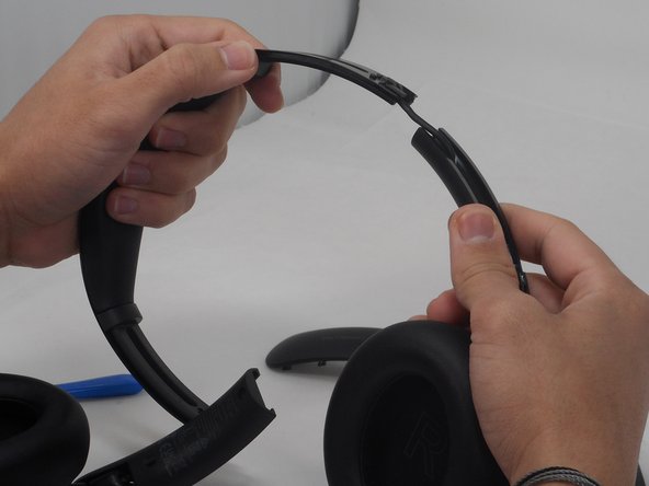

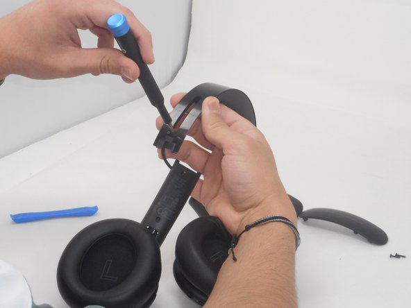

    • Unscrew the two 9.5mm screws from the interior side of the headband using a Phillips #00 screwdriver.
  2. Anker Soundcore Life Q30 Headband Replacement: crwdns2935265:02crwdnd2935265:01crwdnd2935265:03crwdne2935265:0 Anker Soundcore Life Q30 Headband Replacement: crwdns2935265:02crwdnd2935265:02crwdnd2935265:03crwdne2935265:0 Anker Soundcore Life Q30 Headband Replacement: crwdns2935265:02crwdnd2935265:03crwdnd2935265:03crwdne2935265:0
    • Use the opening tool to pry off the exterior covering of the headband.
  3. Anker Soundcore Life Q30 Headband Replacement: crwdns2935265:03crwdnd2935265:01crwdnd2935265:03crwdne2935265:0 Anker Soundcore Life Q30 Headband Replacement: crwdns2935265:03crwdnd2935265:02crwdnd2935265:03crwdne2935265:0 Anker Soundcore Life Q30 Headband Replacement: crwdns2935265:03crwdnd2935265:03crwdnd2935265:03crwdne2935265:0
    • Slide the headband off the lateral extension of the headphones.
    • Take great care to avoid tearing the connecting wire that runs along the headband. Doing so will render the headphones unusable.

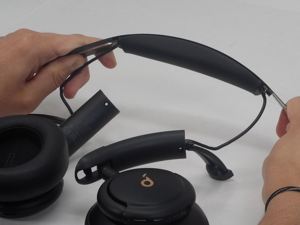

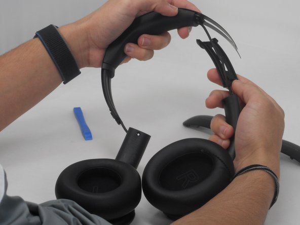

  4. Anker Soundcore Life Q30 Headband Replacement: crwdns2935265:04crwdnd2935265:01crwdnd2935265:02crwdne2935265:0 Anker Soundcore Life Q30 Headband Replacement: crwdns2935265:04crwdnd2935265:02crwdnd2935265:02crwdne2935265:0
    • Orient the headphones such that you are looking at where you originally removed the covering.
    • Unscrew the 2 visible 5.7mm screws on each side using a Phillips #00 screwdriver.

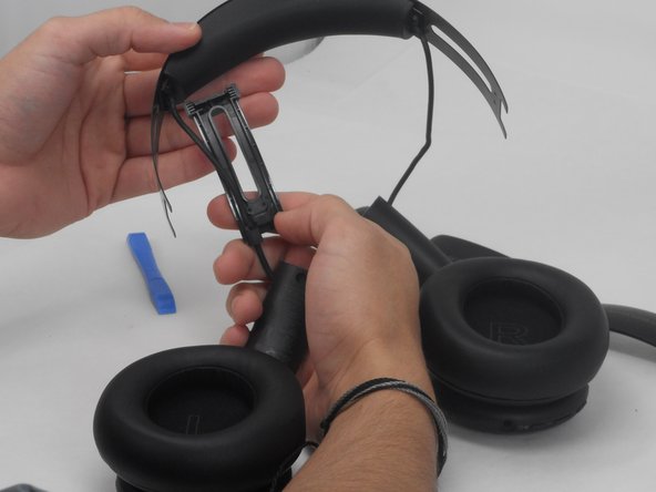

  5. Anker Soundcore Life Q30 Headband Replacement: crwdns2935265:05crwdnd2935265:01crwdnd2935265:03crwdne2935265:0 Anker Soundcore Life Q30 Headband Replacement: crwdns2935265:05crwdnd2935265:02crwdnd2935265:03crwdne2935265:0 Anker Soundcore Life Q30 Headband Replacement: crwdns2935265:05crwdnd2935265:03crwdnd2935265:03crwdne2935265:0
    • Slide off the metal part of the headband from the plastic casing.
    • Take care not to disconnect the wire.

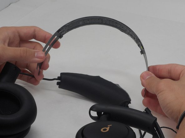

  6. Anker Soundcore Life Q30 Headband Replacement: crwdns2935265:06crwdnd2935265:01crwdnd2935265:02crwdne2935265:0 Anker Soundcore Life Q30 Headband Replacement: crwdns2935265:06crwdnd2935265:02crwdnd2935265:02crwdne2935265:0
    • Gently bend the headband back and forth to loosen the cushion.

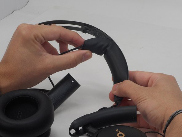

  7. Anker Soundcore Life Q30 Headband Replacement: crwdns2935265:07crwdnd2935265:01crwdnd2935265:03crwdne2935265:0 Anker Soundcore Life Q30 Headband Replacement: crwdns2935265:07crwdnd2935265:02crwdnd2935265:03crwdne2935265:0 Anker Soundcore Life Q30 Headband Replacement: crwdns2935265:07crwdnd2935265:03crwdnd2935265:03crwdne2935265:0
    • You can now remove the headband by gently peeling it off of the frame.
You can attach your replacement headband. This will need to be glued into place. From here, follow these steps in reverse order to reassemble the device.
