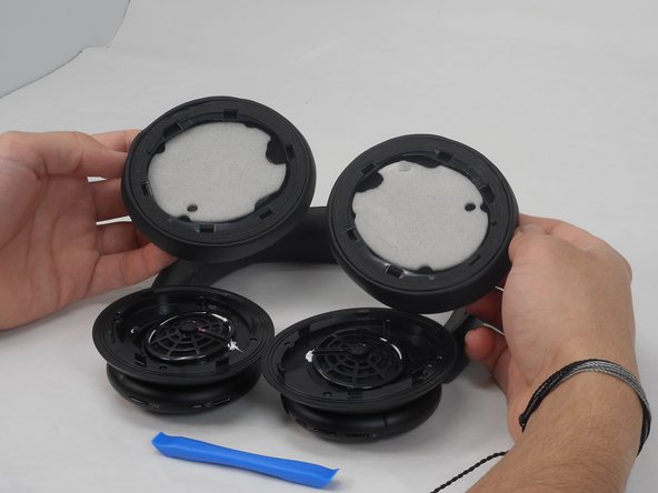

    • Orient the headphones such that the headphone speakers are closest to you, and the headband is furthest from you.
    • Adjust the folding hinge to where the speakers are facing up.
    • Make sure you can easily reach the edge where the cushion connects to the rest of the headphones.
  2. Anker Soundcore Life Q30 Earphone Cushion Replacement: crwdns2935265:02crwdnd2935265:01crwdnd2935265:03crwdne2935265:0 Anker Soundcore Life Q30 Earphone Cushion Replacement: crwdns2935265:02crwdnd2935265:02crwdnd2935265:03crwdne2935265:0 Anker Soundcore Life Q30 Earphone Cushion Replacement: crwdns2935265:02crwdnd2935265:03crwdnd2935265:03crwdne2935265:0
    • Using one hand, hold the right side of the headphones still.
    • Using your other hand, slide the plastic opening tool in the edge along the cushion.
    • Gently pry the cushion off using the plastic opening tool.
    • Set the right ear cushion aside and repeat this step for the left side of the headphones.
  3. Anker Soundcore Life Q30 Earphone Cushion Replacement: crwdns2935265:03crwdnd2935265:01crwdnd2935265:02crwdne2935265:0 Anker Soundcore Life Q30 Earphone Cushion Replacement: crwdns2935265:03crwdnd2935265:02crwdnd2935265:02crwdne2935265:0
    • Remove the white foam pieces from the old cushions, noting their orientation.
    • Insert the white foam pieces from the old cushions into the replacement cushions. Make sure to set them in the same orientation they were in previously.
