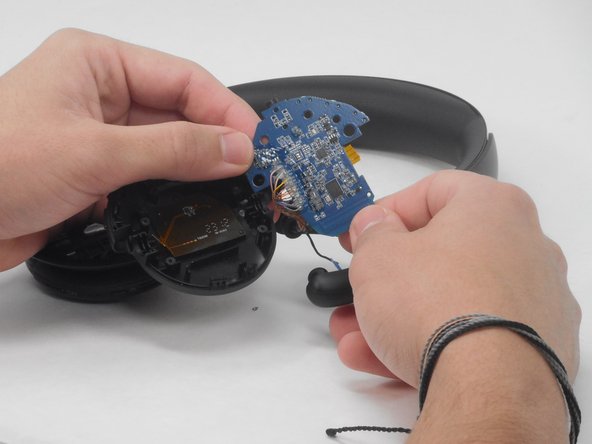

    • Unscrew the 5.7mm screw with a Phillips #00 screwdriver within the green circuit board connected to the battery.
    • Carefully pry the green circuit board and battery off of the earcup.
    • The battery may be glued into place, which will require some force to remove.

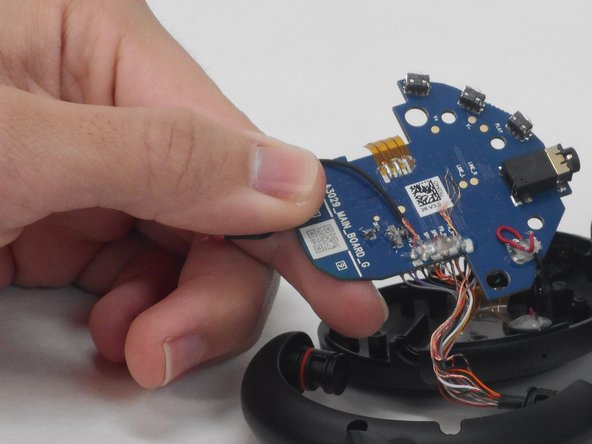

    • You can follow a similar process to open up the right side of the headphones. The main difference is that there is no battery to remove, so there will just be a circuit board that will need to be removed from the earcup.
  9. Anker Soundcore Life Q30 Button Replacement: crwdns2935265:09crwdnd2935265:01crwdnd2935265:02crwdne2935265:0 Anker Soundcore Life Q30 Button Replacement: crwdns2935265:09crwdnd2935265:02crwdnd2935265:02crwdne2935265:0

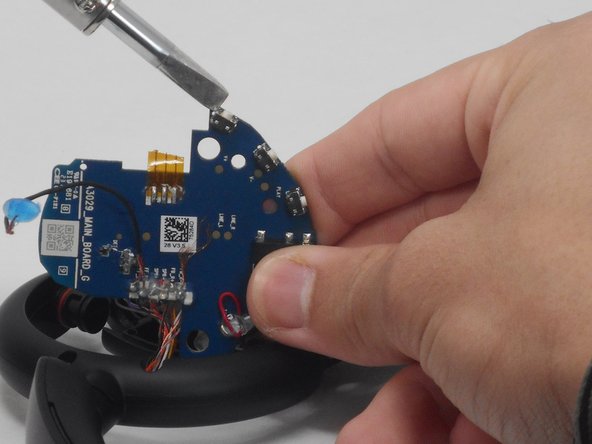

    • After the circuit boards can be accessed, you will need to desolder the button you are trying to replace from it. This guide will be using the right side of the headphones as an example, but the process will be the same for the buttons on the left side. This link will take you to a guide on soldering.
    • You can now solder your replacement button into place. Take care that you orient the button correctly so that it matches the position of the external part of the button.
