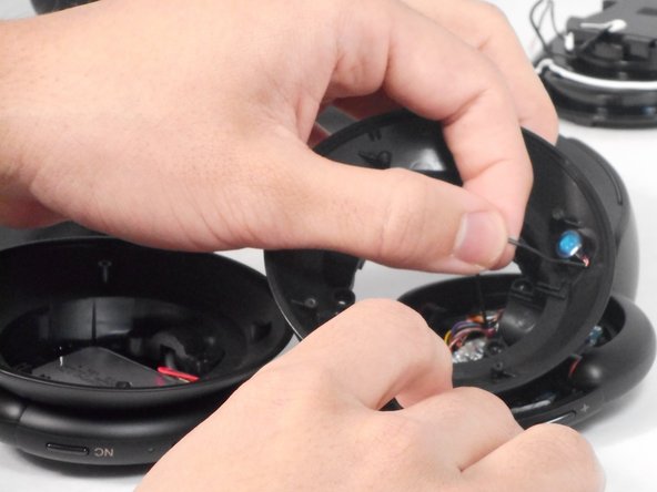

    • Pull the microphone (circular blue part) from its socket by the connected red wire that is covered in black rubber.
    • Take note of where the microphone is, as you will have to reconnect it.
    • The wire itself is connected to the battery and will disconnect the battery from the exterior piece of the earcup.

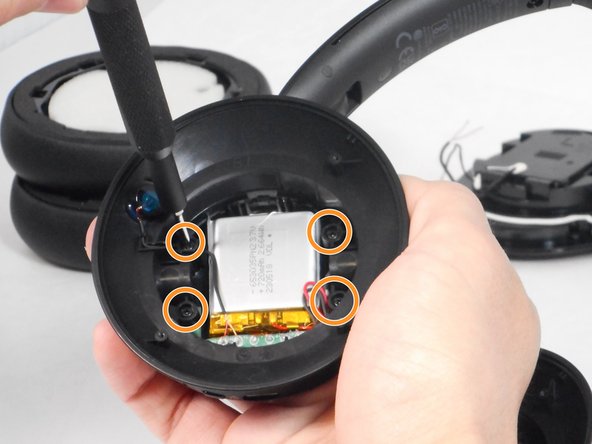

    • Unscrew the four 5.7 mm screws with a Phillips #00 screwdriver connecting the earcup to the headphone’s frame.
    • Remove the earcup.

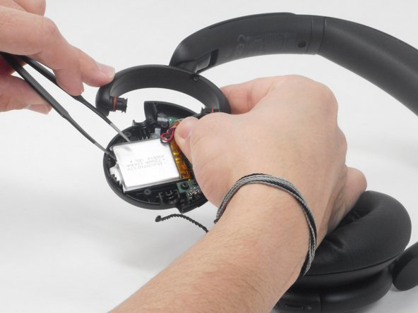

    • Unscrew the 5.7mm screw with a Phillips #00 screwdriver within the green circuit board connected to the battery.
    • Carefully pry the green circuit board and battery off of the earcup.
    • The battery may be glued into place, which will require some force to remove.

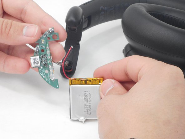

    • Remove the wires connecting the battery from the circuit board.
    • Note the placement of the wires you remove, as you will have to solder them back into place.
From here, you’ll have to solder your replacement battery into place. After doing so, follow these steps in reverse order to reassemble the device.
