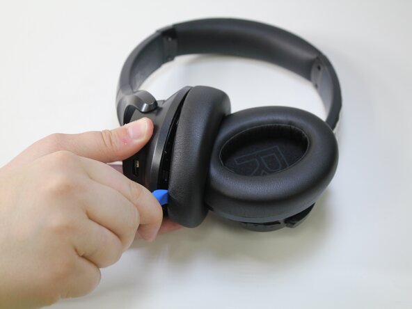

  2. Anker Soundcore Life Q20 Buttons Replacement: crwdns2935265:02crwdnd2935265:01crwdnd2935265:02crwdne2935265:0 Anker Soundcore Life Q20 Buttons Replacement: crwdns2935265:02crwdnd2935265:02crwdnd2935265:02crwdne2935265:0
    • Wedge the iFixit opening tool into the groove where the ear cushion meets the base of the headphones.
    • Pry the ear cushion apart from the base.

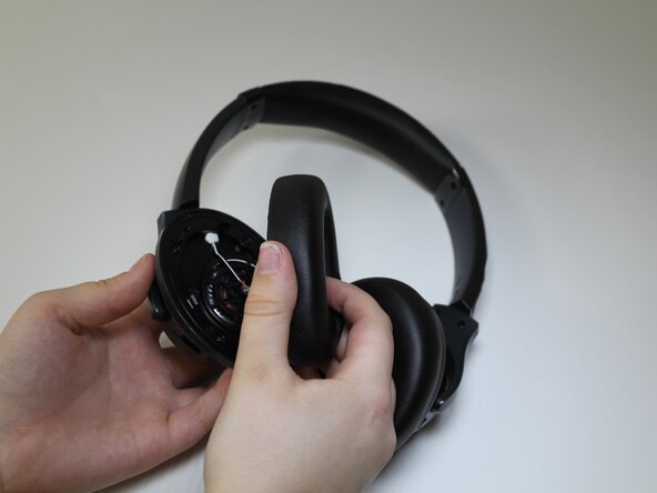

  3. Anker Soundcore Life Q20 Buttons Replacement: crwdns2935265:03crwdnd2935265:01crwdnd2935265:02crwdne2935265:0 Anker Soundcore Life Q20 Buttons Replacement: crwdns2935265:03crwdnd2935265:02crwdnd2935265:02crwdne2935265:0
    • Repeat step 2 in a rotation around the ear cushion until it is fully detached from the base.

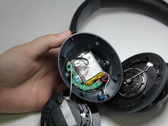

  4. Anker Soundcore Life Q20 Buttons Replacement, Battery: crwdns2935265:04crwdnd2935265:01crwdnd2935265:03crwdne2935265:0 Anker Soundcore Life Q20 Buttons Replacement, Battery: crwdns2935265:04crwdnd2935265:02crwdnd2935265:03crwdne2935265:0 Anker Soundcore Life Q20 Buttons Replacement, Battery: crwdns2935265:04crwdnd2935265:03crwdnd2935265:03crwdne2935265:0
    • Use a Phillips #00 screwdriver to remove the four 10 mm screws from the cover.
    • Remove the cover to expose the battery.
  5. Anker Soundcore Life Q20 Buttons Replacement: crwdns2935265:05crwdnd2935265:01crwdnd2935265:01crwdne2935265:0
    • Use your index finger to lift the battery and remove it from the base.
    • Desolder the battery from the board, following the instructions from the iFixit soldering guide: How To Solder and Desolder Connections

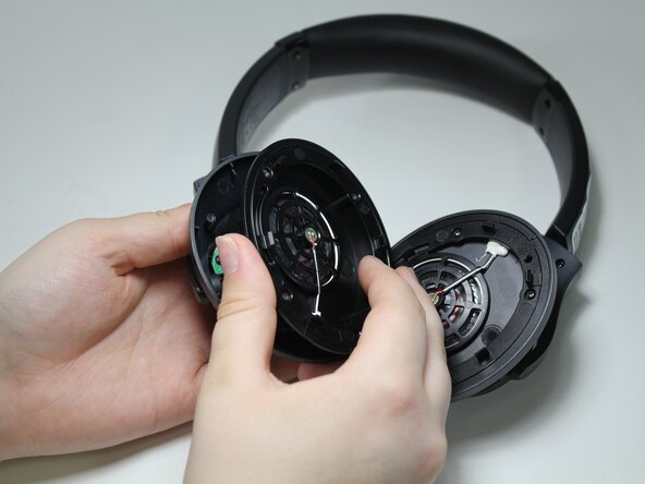

  6. Anker Soundcore Life Q20 Buttons Replacement, Buttons: crwdns2935265:06crwdnd2935265:01crwdnd2935265:01crwdne2935265:0
    • Using the Phillips #00 screwdriver, remove the two 7 mm screws from the green board.
  7. Anker Soundcore Life Q20 Buttons Replacement: crwdns2935265:07crwdnd2935265:01crwdnd2935265:01crwdne2935265:0
    • Press the buttons as usual to pop them out of the base.
    • Gently pull the remaining tabs inside the base to disconnect the buttons.
