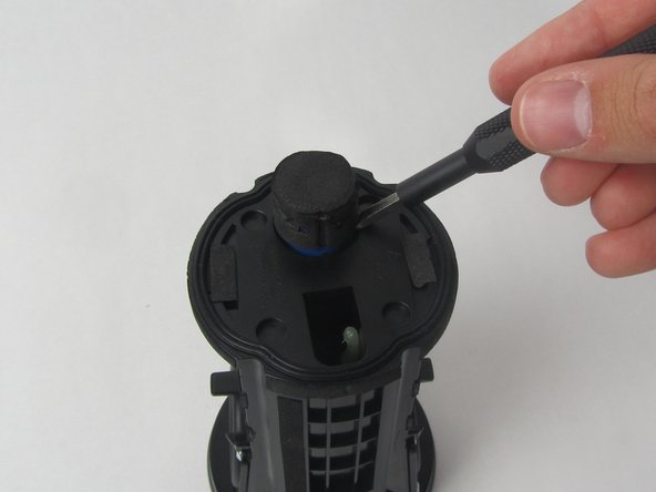

  9. Anker Soundcore Flare Mini Battery Replacement, Battery: crwdns2935265:09crwdnd2935265:01crwdnd2935265:03crwdne2935265:0 Anker Soundcore Flare Mini Battery Replacement, Battery: crwdns2935265:09crwdnd2935265:02crwdnd2935265:03crwdne2935265:0 Anker Soundcore Flare Mini Battery Replacement, Battery: crwdns2935265:09crwdnd2935265:03crwdnd2935265:03crwdne2935265:0
    • Use a spudger to pry the battery out.
    • It will be tough to start, but once you work the top part of the battery out with the spudger, you can pull it the rest of the way by hand.

where can I buy the battery replacement component ?
Andre Walters - crwdns2934203:0crwdne2934203:0
Amazon, search for “rechargeable lithium ion battery 18650” it has to be a 2600 mAh 3.7v. I didn’t find one with the same connector so I just soldered the old one to the new battery, it works fine.
Mario Ojeda -
Would be nice to have guidance on how to get the shell cable back through the channel. Also, have people had any issues replacing the battery without the foam padding securing it in it's slot?
