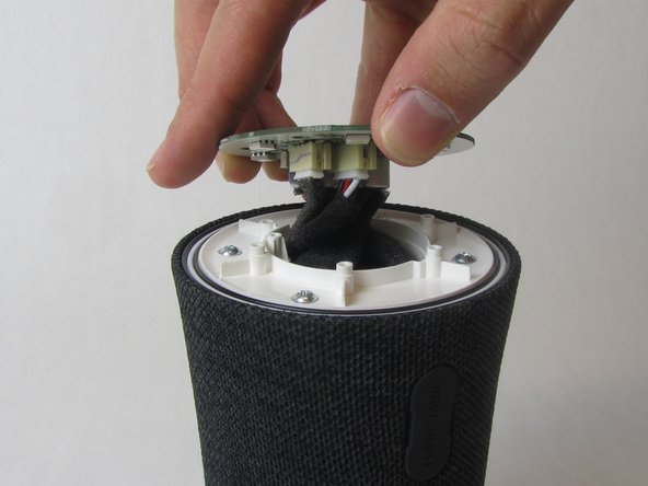

  3. Anker Soundcore Flare Mini Audio Drivers Replacement, Motherboard: crwdns2935265:03crwdnd2935265:01crwdnd2935265:03crwdne2935265:0 Anker Soundcore Flare Mini Audio Drivers Replacement, Motherboard: crwdns2935265:03crwdnd2935265:02crwdnd2935265:03crwdne2935265:0 Anker Soundcore Flare Mini Audio Drivers Replacement, Motherboard: crwdns2935265:03crwdnd2935265:03crwdnd2935265:03crwdne2935265:0
    • Remove the single 10 mm screw holding the motherboard in place using a Phillips #1 screwdriver.
    • Lift the motherboard up.
    • The motherboard is still attached to several wires underneath.

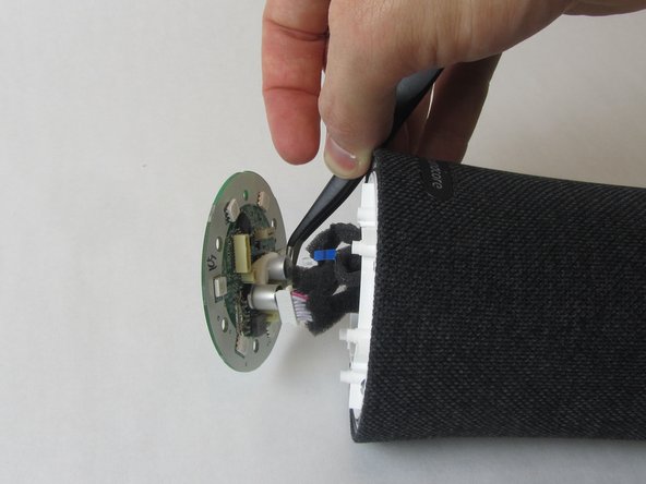

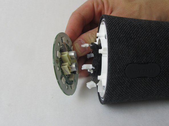

  4. Anker Soundcore Flare Mini Audio Drivers Replacement: crwdns2935265:04crwdnd2935265:01crwdnd2935265:03crwdne2935265:0 Anker Soundcore Flare Mini Audio Drivers Replacement: crwdns2935265:04crwdnd2935265:02crwdnd2935265:03crwdne2935265:0 Anker Soundcore Flare Mini Audio Drivers Replacement: crwdns2935265:04crwdnd2935265:03crwdnd2935265:03crwdne2935265:0
    • Use precision tweezers to firmly grasp the five power connectors and detach them from the back of the motherboard.
    • When removing the power connectors, do not pull the wires themselves.
    • Remove the motherboard from the speaker.

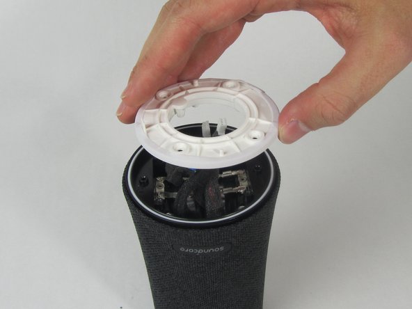

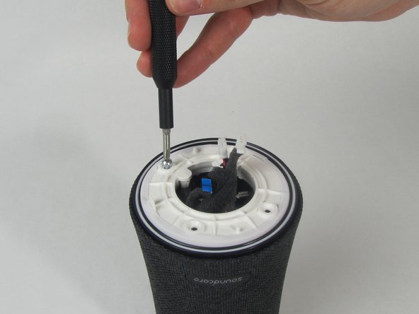

  5. Anker Soundcore Flare Mini Audio Drivers Replacement, Waterproof Outer Shell: crwdns2935265:05crwdnd2935265:01crwdnd2935265:03crwdne2935265:0 Anker Soundcore Flare Mini Audio Drivers Replacement, Waterproof Outer Shell: crwdns2935265:05crwdnd2935265:02crwdnd2935265:03crwdne2935265:0 Anker Soundcore Flare Mini Audio Drivers Replacement, Waterproof Outer Shell: crwdns2935265:05crwdnd2935265:03crwdnd2935265:03crwdne2935265:0
    • Remove the four 11 mm screws from the white plastic cover using a Phillips #1 screwdriver.
    • Remove the white plastic cover from the speaker.

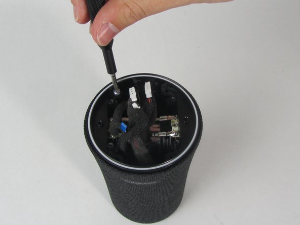

  6. Anker Soundcore Flare Mini Audio Drivers Replacement: crwdns2935265:06crwdnd2935265:01crwdnd2935265:02crwdne2935265:0 Anker Soundcore Flare Mini Audio Drivers Replacement: crwdns2935265:06crwdnd2935265:02crwdnd2935265:02crwdne2935265:0
    • Remove the other four 11 mm screws holding the outer shell in place with a Phillips #1 screwdriver.

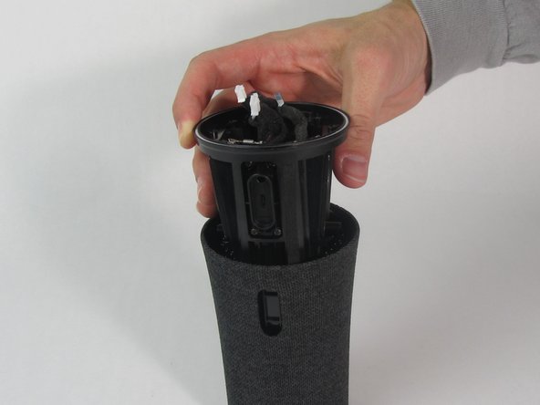

  8. Anker Soundcore Flare Mini Audio Drivers Replacement: crwdns2935265:08crwdnd2935265:01crwdnd2935265:03crwdne2935265:0 Anker Soundcore Flare Mini Audio Drivers Replacement: crwdns2935265:08crwdnd2935265:02crwdnd2935265:03crwdne2935265:0 Anker Soundcore Flare Mini Audio Drivers Replacement: crwdns2935265:08crwdnd2935265:03crwdnd2935265:03crwdne2935265:0
    • Use a spudger to loosen the cover from the inner components of the speaker.
    • Slide the cover completely off.
    • One wire will still be connected to the shell.

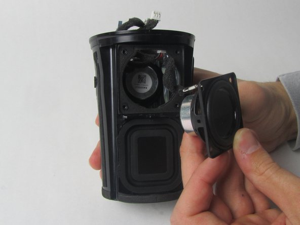

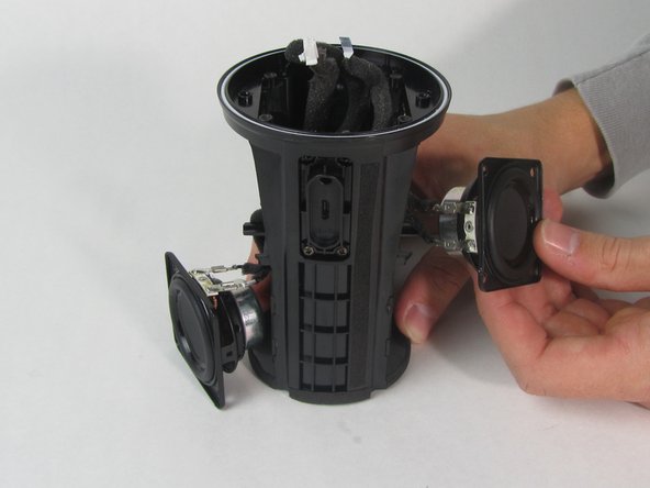

  9. Anker Soundcore Flare Mini Audio Drivers Replacement, Audio Drivers: crwdns2935265:09crwdnd2935265:01crwdnd2935265:03crwdne2935265:0 Anker Soundcore Flare Mini Audio Drivers Replacement, Audio Drivers: crwdns2935265:09crwdnd2935265:02crwdnd2935265:03crwdne2935265:0 Anker Soundcore Flare Mini Audio Drivers Replacement, Audio Drivers: crwdns2935265:09crwdnd2935265:03crwdnd2935265:03crwdne2935265:0
    • There are two drivers—one on each side of the speaker.
    • Use a Phillips #1 screwdriver to remove the four 11 mm screws from one driver.
    • Use your hand to pull the driver out of the device.
    • Repeat this step with the other driver.

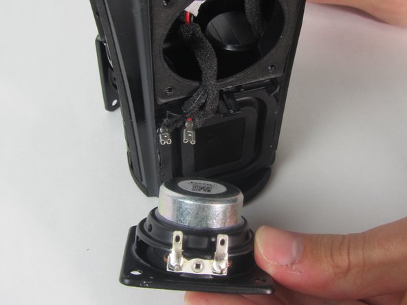

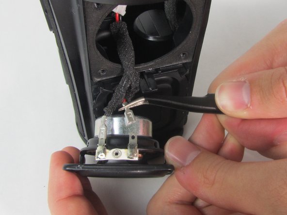

  10. Anker Soundcore Flare Mini Audio Drivers Replacement: crwdns2935265:010crwdnd2935265:01crwdnd2935265:03crwdne2935265:0 Anker Soundcore Flare Mini Audio Drivers Replacement: crwdns2935265:010crwdnd2935265:02crwdnd2935265:03crwdne2935265:0 Anker Soundcore Flare Mini Audio Drivers Replacement: crwdns2935265:010crwdnd2935265:03crwdnd2935265:03crwdne2935265:0
    • Use precision tweezers to detach the two wire connectors from the driver.
    • Both drivers are connected to the same wire so removing one side will separate the other driver from the device as well.
    • Remove both drivers from the device.
