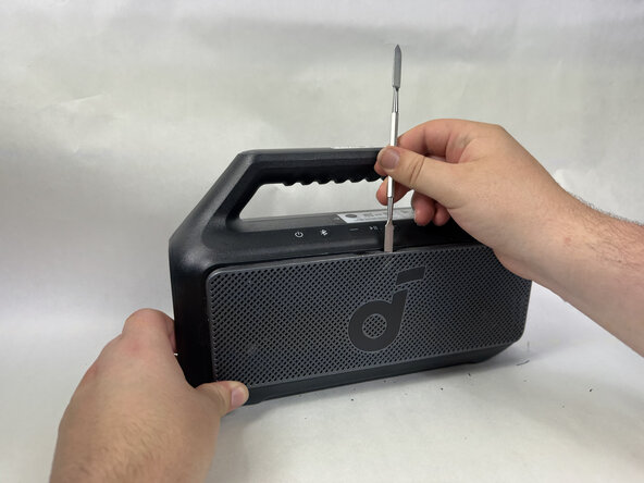

  1. Anker Soundcore Boom 2 Battery Replacement, Front Panel: crwdns2935265:01crwdnd2935265:01crwdnd2935265:02crwdne2935265:0 Anker Soundcore Boom 2 Battery Replacement, Front Panel: crwdns2935265:01crwdnd2935265:02crwdnd2935265:02crwdne2935265:0
    • Use a metal spudger to gently pry the front panel off of the speaker.
    • Start with the top of the panel, pressing in and down on the middle of the top of the panel to release the tab holding it in place.
  2. Anker Soundcore Boom 2 Battery Replacement: crwdns2935265:02crwdnd2935265:01crwdnd2935265:01crwdne2935265:0
    • Continue around edge of the front panel, releasing each tab until the panel is loose and comes free.
    • Some speaker models have a strong adhesive around the edge of the panel that may require heat or glue-remover to loosen.

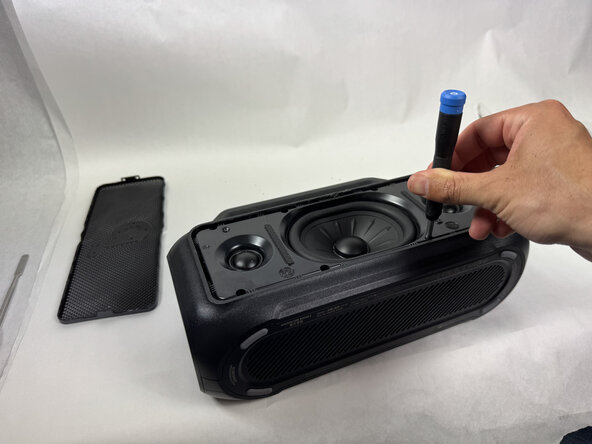

  3. Anker Soundcore Boom 2 Battery Replacement, Speaker Head: crwdns2935265:03crwdnd2935265:01crwdnd2935265:02crwdne2935265:0 Anker Soundcore Boom 2 Battery Replacement, Speaker Head: crwdns2935265:03crwdnd2935265:02crwdnd2935265:02crwdne2935265:0
    • Use a Phillips head screwdriver to remove the 8 screws surrounding the speaker head on the front facing panel.

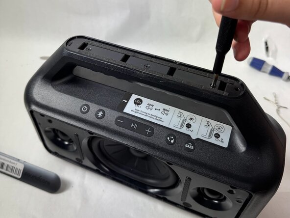

  5. Anker Soundcore Boom 2 Battery Replacement: crwdns2935265:05crwdnd2935265:01crwdnd2935265:02crwdne2935265:0 Anker Soundcore Boom 2 Battery Replacement: crwdns2935265:05crwdnd2935265:02crwdnd2935265:02crwdne2935265:0
    • Remove the 3 screws in the handle with a Phillips head screwdriver.

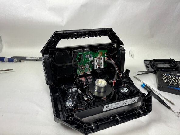

  6. Anker Soundcore Boom 2 Battery Replacement: crwdns2935265:06crwdnd2935265:01crwdnd2935265:02crwdne2935265:0 Anker Soundcore Boom 2 Battery Replacement: crwdns2935265:06crwdnd2935265:02crwdnd2935265:02crwdne2935265:0
    • Use a spudger to separate the front facing panel from the rear facing panel.
    • Follow the seam all the way around the device, prying gently until a gap appears before moving further along.
    • This will split the device from front and back.

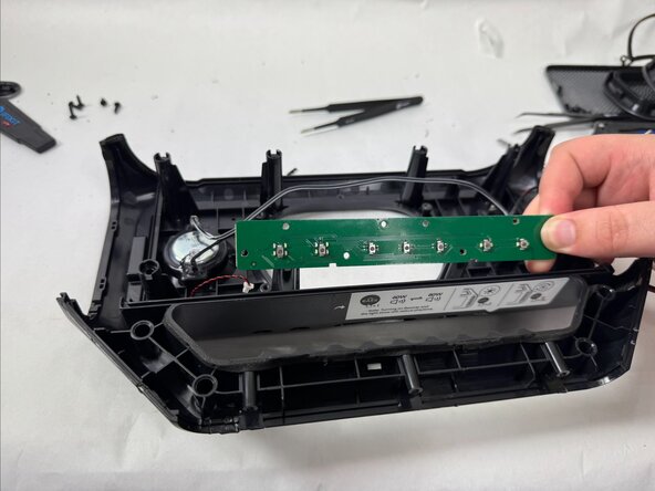

  12. Anker Soundcore Boom 2 Battery Replacement: crwdns2935265:012crwdnd2935265:01crwdnd2935265:02crwdne2935265:0 Anker Soundcore Boom 2 Battery Replacement: crwdns2935265:012crwdnd2935265:02crwdnd2935265:02crwdne2935265:0
    • Use a Phillips head screwdriver to remove the 8 screws from the button panel.
    • Carefully slide the button panel out of place.

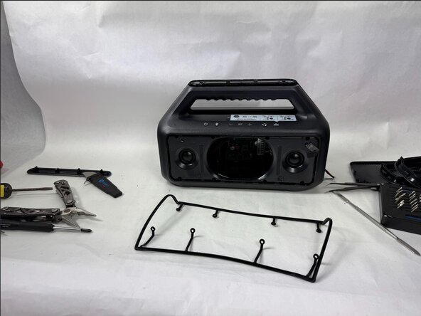

  13. Anker Soundcore Boom 2 Battery Replacement, Waterproof Gasket: crwdns2935265:013crwdnd2935265:01crwdnd2935265:02crwdne2935265:0 Anker Soundcore Boom 2 Battery Replacement, Waterproof Gasket: crwdns2935265:013crwdnd2935265:02crwdnd2935265:02crwdne2935265:0
    • With the device pulled apart and the wires to the speaker head and button panel disconnected, remove the gasket from around the edge of the internal compartment.
