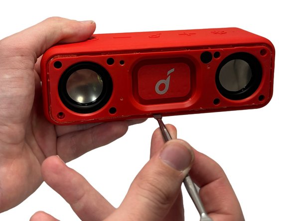

    • Insert the metal spudger in between the speaker's front panel and casing
    • Continuously pry around the edges of the casing; you should hear the glue start to separate from the front panel before the two parts separate.

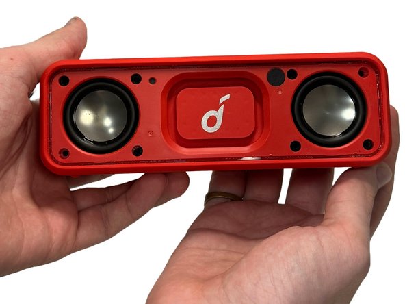

    • Remove 8 of the 10 mm screws from the speaker panel using a Phillips #0 screwdriver.

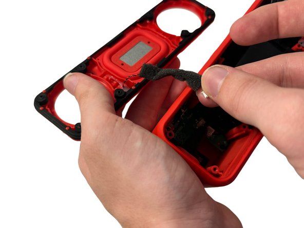

    • Using the metal spudger, gently pry at the outer-edges of the speaker to remove the rubber/plastic panel that sits above the motherboard.
    • Grip and disconnect the cable connector from both the rubber/plastic panel and the mainboard.
