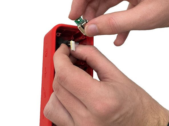

    • Gently heat the perimeter of the device with a hairdryer to loosen the adhesive.
    • Insert a metal spudger in between the speaker's front grill and chassis.
    • Continuously pry around the edges of the casing; you should hear the glue start to separate from the front panel before the two parts separate.
  2. Anker Soundcore 3 Charging Port Replacement: crwdns2935265:02crwdnd2935265:01crwdnd2935265:03crwdne2935265:0 Anker Soundcore 3 Charging Port Replacement: crwdns2935265:02crwdnd2935265:02crwdnd2935265:03crwdne2935265:0 Anker Soundcore 3 Charging Port Replacement: crwdns2935265:02crwdnd2935265:03crwdnd2935265:03crwdne2935265:0
    • Remove 8 of the 10 mm screws from the speaker panel using a Phillips #0 screwdriver.
    • Using the metal spudger, gently pry at the outer-edges of the speaker to remove the rubber/plastic panel that sits above the motherboard.
    • Grip and disconnect the cable connector from both the rubber/plastic panel and the mainboard.
  3. Anker Soundcore 3 Charging Port Replacement: crwdns2935265:03crwdnd2935265:01crwdnd2935265:02crwdne2935265:0 Anker Soundcore 3 Charging Port Replacement: crwdns2935265:03crwdnd2935265:02crwdnd2935265:02crwdne2935265:0
    • Remove the four 10 mm screws that secure the battery with a Phillips #00 screwdriver.
    • Firmly grasp the connector cable and gently pull up to remove it from the mainboard.
    • Remove the battery.
  4. Anker Soundcore 3 Charging Port Replacement, Charging Port: crwdns2935265:04crwdnd2935265:01crwdnd2935265:02crwdne2935265:0 Anker Soundcore 3 Charging Port Replacement, Charging Port: crwdns2935265:04crwdnd2935265:02crwdnd2935265:02crwdne2935265:0
    • Remove the two 10 mm screws that secure the charging port with a Phillips #00 screwdriver.
    • Using a metal spudger, remove any glue that may be holding the charging cable in place.
    • Firmly grasp the cable and disconnect it from the charging port.
    • Remove the charging port.
