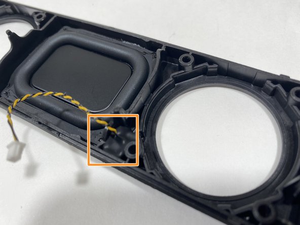

  3. Anker SoundCore 2 Microphone Replacement: crwdns2935265:03crwdnd2935265:01crwdnd2935265:03crwdne2935265:0 Anker SoundCore 2 Microphone Replacement: crwdns2935265:03crwdnd2935265:02crwdnd2935265:03crwdne2935265:0 Anker SoundCore 2 Microphone Replacement: crwdns2935265:03crwdnd2935265:03crwdnd2935265:03crwdne2935265:0
    • Disconnect the microphone wire from the motherboard.
    • Use a spudger to pry the microphone out of the speaker mount panel.
    • The microphone is held in place with glue, so you may need to re-glue the new microphone onto the speaker mount panel.
