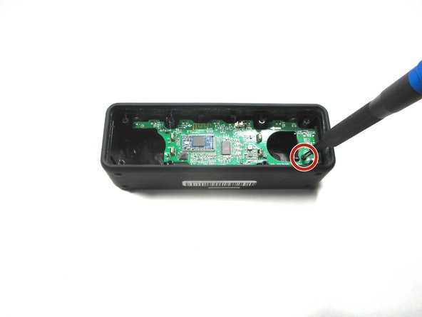

  3. Anker SoundCore 2 Charging Port Replacement: crwdns2935265:03crwdnd2935265:01crwdnd2935265:03crwdne2935265:0 Anker SoundCore 2 Charging Port Replacement: crwdns2935265:03crwdnd2935265:02crwdnd2935265:03crwdne2935265:0 Anker SoundCore 2 Charging Port Replacement: crwdns2935265:03crwdnd2935265:03crwdnd2935265:03crwdne2935265:0
    • Remove the 10 mm screw that is holding the motherboard in place using a Phillips #0 screwdriver.
    • Flip up the motherboard and disconnect the cord that connects the motherboard and the battery.
  4. Anker SoundCore 2 Charging Port Replacement, Charging Port: crwdns2935265:04crwdnd2935265:01crwdnd2935265:02crwdne2935265:0 Anker SoundCore 2 Charging Port Replacement, Charging Port: crwdns2935265:04crwdnd2935265:02crwdnd2935265:02crwdne2935265:0
    • Desolder the charging port from the motherboard and solder a new one on.
    • For help with soldering and desoldering, follow this guide.
