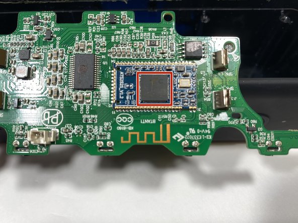

  4. Anker SoundCore 2 Bluetooth Chip Replacement, Bluetooth Chip: crwdns2935265:04crwdnd2935265:01crwdnd2935265:02crwdne2935265:0 Anker SoundCore 2 Bluetooth Chip Replacement, Bluetooth Chip: crwdns2935265:04crwdnd2935265:02crwdnd2935265:02crwdne2935265:0
    • Desolder the bluetooth chip and solder a new one on the motherboard where the existing one was.
    • For help desoldering and soldering, follow this guide.
