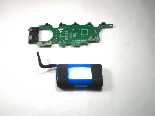

    2. Anker SoundCore 2 Battery Replacement: crwdns2935265:03crwdnd2935265:01crwdnd2935265:03crwdne2935265:0 Anker SoundCore 2 Battery Replacement: crwdns2935265:03crwdnd2935265:02crwdnd2935265:03crwdne2935265:0 Anker SoundCore 2 Battery Replacement: crwdns2935265:03crwdnd2935265:03crwdnd2935265:03crwdne2935265:0
      • Remove the 10 mm screw that is holding the motherboard in place using a Phillips #1 screwdriver. Some variants have 2 screws.
      • Carefully remove the bluetooth antenna wire from the left of the board. It pulls up without much pressure.
      • Flip up the motherboard to expose the battery.
    3. Anker SoundCore 2 Battery Replacement: crwdns2935265:04crwdnd2935265:01crwdnd2935265:02crwdne2935265:0 Anker SoundCore 2 Battery Replacement: crwdns2935265:04crwdnd2935265:02crwdnd2935265:02crwdne2935265:0
      • Use a nylon spudger to remove the battery from the speaker casing.
      • Caution: Do not use metal prying tools on a battery—these can puncture an unprotected battery, potentially causing a fire.
      • The battery is glued down so it may be difficult to remove.
    4. Anker SoundCore 2 Battery Replacement: crwdns2935265:05crwdnd2935265:01crwdnd2935265:02crwdne2935265:0 Anker SoundCore 2 Battery Replacement: crwdns2935265:05crwdnd2935265:02crwdnd2935265:02crwdne2935265:0
      • Unplug the wire that connects the battery with the motherboard.
      • Battery specs: 2 x 18650 2600mAh soldered in series (to bring voltage to 7.4V).
      • Can safely be upgraded to 2 x 18650 3500mAh for additional capacity.
      • When replacing the battery, plug in the new battery where the old one was plugged in.

It would be nice to have the specifications of the battery so availability can be checked before disassembly.
Michael Anderson - crwdns2934203:0crwdne2934203:0 crwdns2950251:0crwdne2950251:0
7.2V, 2550 mAh, 18.36 Watt - Hour
Kang Le - crwdns2934203:0crwdne2934203:0 crwdns2950251:0crwdne2950251:0

Akku SoundCore2
Kapazität 2600 mAh Leistung 19.24 Wh Spannung 7.4 V Typ Li-ion
