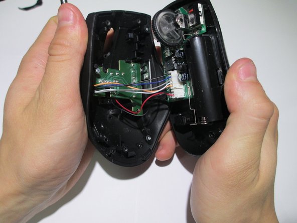

    • Use a spudger to pry apart the upper and lower housing of the mouse.
  4. Anker 2.4G Wireless Mouse Left and Right Button Replacement: crwdns2935265:04crwdnd2935265:01crwdnd2935265:01crwdne2935265:0
    • Pull the wires from the white crimping headers to disconnect them. This separates the top housing from the bottom housing.
    • Pull as far up on the wires as possible. Be careful not to rip the wires by applying too much force.

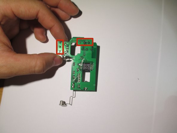

  7. Anker 2.4G Wireless Mouse Left and Right Button Replacement: crwdns2935265:07crwdnd2935265:01crwdnd2935265:02crwdne2935265:0 Anker 2.4G Wireless Mouse Left and Right Button Replacement: crwdns2935265:07crwdnd2935265:02crwdnd2935265:02crwdne2935265:0
    • Desolder the components and re-solder the replacements in order to repair the left and right buttons.
