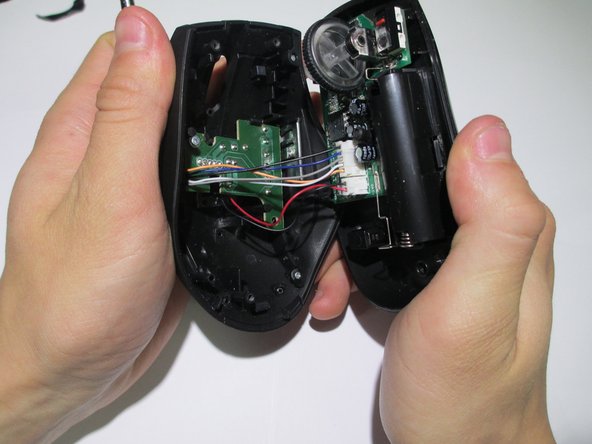

    3. Anker 2.4G Wireless Mouse LED Replacement: crwdns2935265:03crwdnd2935265:01crwdnd2935265:02crwdne2935265:0 Anker 2.4G Wireless Mouse LED Replacement: crwdns2935265:03crwdnd2935265:02crwdnd2935265:02crwdne2935265:0
      • Pry the center of the mouse apart using a spudger to separate the upper and lower housing of the boards.
    4. Anker 2.4G Wireless Mouse LED Replacement: crwdns2935265:04crwdnd2935265:01crwdnd2935265:01crwdne2935265:0
      • Remove the wires from the white crimp headers. This will separate the upper and lower housing units of the mouse.
      • Pull as far up on the wire as possible, but be careful to avoid ripping the wires.

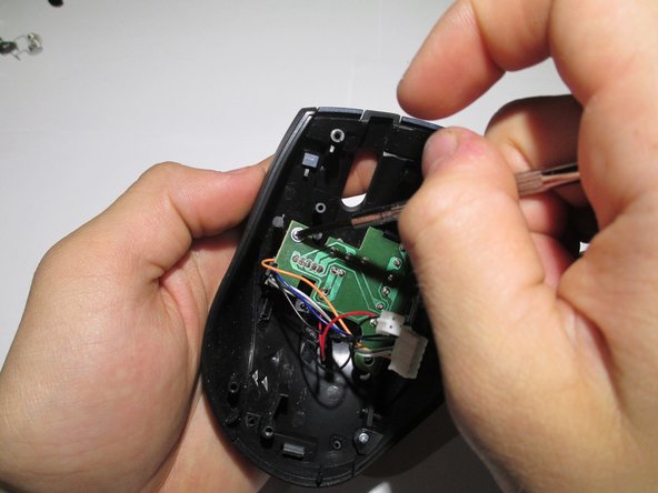

    5. Anker 2.4G Wireless Mouse LED Replacement: crwdns2935265:05crwdnd2935265:01crwdnd2935265:02crwdne2935265:0 Anker 2.4G Wireless Mouse LED Replacement: crwdns2935265:05crwdnd2935265:02crwdnd2935265:02crwdne2935265:0
      • Take the upper housing of the mouse and remove the two screws that hold the board in place.
    6. Anker 2.4G Wireless Mouse LED Replacement: crwdns2935265:06crwdnd2935265:01crwdnd2935265:01crwdne2935265:0
      • Gently remove the circuit board from the mouse.
    7. Anker 2.4G Wireless Mouse LED Replacement: crwdns2935265:07crwdnd2935265:01crwdnd2935265:01crwdne2935265:0
      • To remove the LED, flip the board over and desolder the wires.
      • Replace LED with a new LED and resolder into place.
