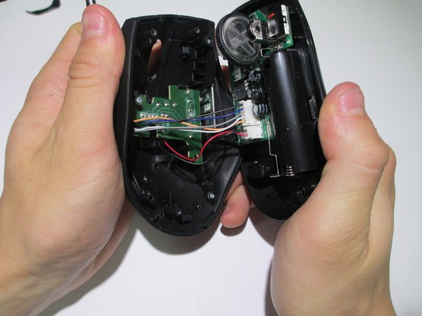

      • Pry the center of the mouse apart to separate the upper and lower housing of the boards.
    4. Anker 2.4G Wireless Mouse DPI button Replacement: crwdns2935265:04crwdnd2935265:01crwdnd2935265:01crwdne2935265:0
      • Remove the wires from the white crimp headers. this will separate the upper and lower housing units of the mouse.
      • Pull as far up on the wire as possible, being as careful as possible to avoid ripping the wires.

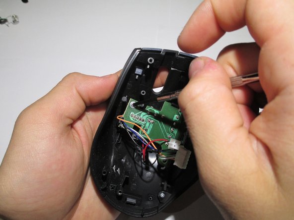

    5. Anker 2.4G Wireless Mouse DPI button Replacement: crwdns2935265:05crwdnd2935265:01crwdnd2935265:02crwdne2935265:0 Anker 2.4G Wireless Mouse DPI button Replacement: crwdns2935265:05crwdnd2935265:02crwdnd2935265:02crwdne2935265:0
      • Take the upper housing of the mouse and begin to remove the two screws (highlighted in red) that hold the board in place.
    6. Anker 2.4G Wireless Mouse DPI button Replacement: crwdns2935265:06crwdnd2935265:01crwdnd2935265:01crwdne2935265:0
      • Gently remove board.

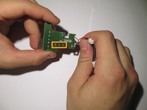

    7. Anker 2.4G Wireless Mouse DPI button Replacement: crwdns2935265:07crwdnd2935265:01crwdnd2935265:02crwdne2935265:0 Anker 2.4G Wireless Mouse DPI button Replacement: crwdns2935265:07crwdnd2935265:02crwdnd2935265:02crwdne2935265:0
      • The DPI button is the red push button highlighted in red.
      • To remove it, flip the board over and desolder the wires highlighted in orange.
      • Replace component with new component and resolder back in place.
