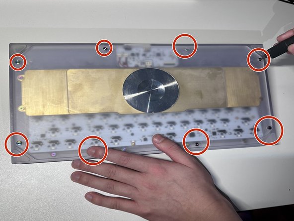

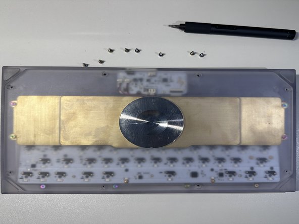

    • Facing the keyboard downwards, remove eight 26 mm screws holding the keyboard together.
    • Rotate the screws in a counterclockwise motion to unscrew.
  2. Angry Miao Xmas Key Switch Replacement: crwdns2935265:02crwdnd2935265:01crwdnd2935265:01crwdne2935265:0
    • Remove the 4 screws of the brass weight in the same counterclockwise motion as done in previous steps.
  3. Angry Miao Xmas Key Switch Replacement: crwdns2935265:03crwdnd2935265:01crwdnd2935265:02crwdne2935265:0 Angry Miao Xmas Key Switch Replacement: crwdns2935265:03crwdnd2935265:02crwdnd2935265:02crwdne2935265:0

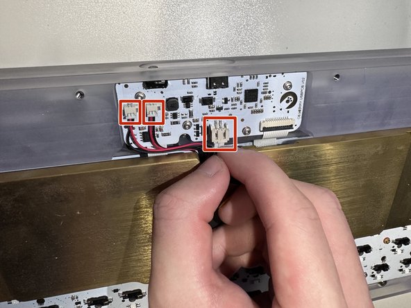

    • Carefully disconnect the brass battery from the top housing by removing the 3 cables.

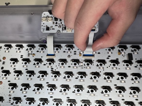

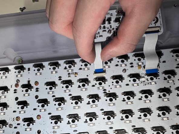

    • When flipped upside down, the back of keyboard will look like this.
    • Remove the brass weight, then disconnect the keyboard PCB by removing the 2 ribbons from the latch holding it down.

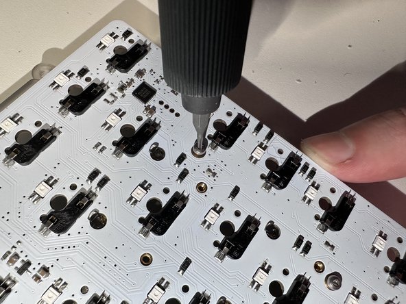

  5. Angry Miao Xmas Key Switch Replacement: crwdns2935265:05crwdnd2935265:01crwdnd2935265:01crwdne2935265:0
    • Remove the 2 screws attached on top and take PCB kit out.

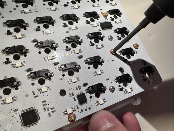

    • Remove the rest of the screws in the same way which will separate the plate, mute mount, and PCB.
  7. Angry Miao Xmas Key Switch Replacement: crwdns2935265:07crwdnd2935265:01crwdnd2935265:03crwdne2935265:0 Angry Miao Xmas Key Switch Replacement: crwdns2935265:07crwdnd2935265:02crwdnd2935265:03crwdne2935265:0 Angry Miao Xmas Key Switch Replacement: crwdns2935265:07crwdnd2935265:03crwdnd2935265:03crwdne2935265:0

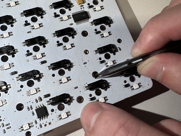

    • Clean the PCB.
    • Pull out the cover by using tweezers.
