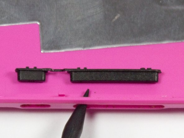

    • Use a screwdriver to remove the two 00 Phillips screws on the right side of the tablet.
  2. Android tablet Nobis NB09 Button Replacement: crwdns2935265:02crwdnd2935265:01crwdnd2935265:02crwdne2935265:0 Android tablet Nobis NB09 Button Replacement: crwdns2935265:02crwdnd2935265:02crwdnd2935265:02crwdne2935265:0
    • Use the plastic opening tool to loosen, and pry off the back case.
    • Use caution when prying around the tablet ports so they do not crack.
  3. Android tablet Nobis NB09 Button Replacement: crwdns2935265:03crwdnd2935265:01crwdnd2935265:02crwdne2935265:0 Android tablet Nobis NB09 Button Replacement: crwdns2935265:03crwdnd2935265:02crwdnd2935265:02crwdne2935265:0
    • The buttons are located on the bottom left hand corner of pink back plate. Simply pop old buttons out with spudger or similar tool.
