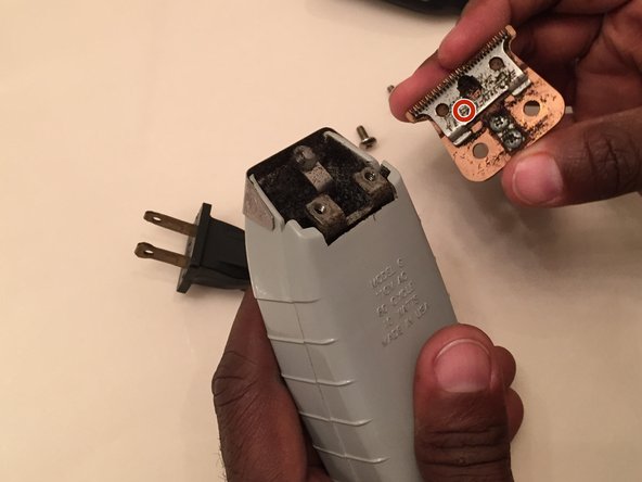

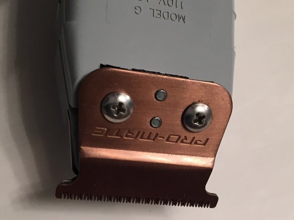

  2. Andis T Outliner Trimmer with T Blade Model G Top Blade Replacement, Remove two blade screws from top blade.: crwdns2935265:02crwdnd2935265:01crwdnd2935265:03crwdne2935265:0 Andis T Outliner Trimmer with T Blade Model G Top Blade Replacement, Remove two blade screws from top blade.: crwdns2935265:02crwdnd2935265:02crwdnd2935265:03crwdne2935265:0 Andis T Outliner Trimmer with T Blade Model G Top Blade Replacement, Remove two blade screws from top blade.: crwdns2935265:02crwdnd2935265:03crwdnd2935265:03crwdne2935265:0
    • Remove the two blade screws from the top blade of the trimmer.
  3. Andis T Outliner Trimmer with T Blade Model G Top Blade Replacement, Lift top blade from the device.: crwdns2935265:03crwdnd2935265:01crwdnd2935265:02crwdne2935265:0 Andis T Outliner Trimmer with T Blade Model G Top Blade Replacement, Lift top blade from the device.: crwdns2935265:03crwdnd2935265:02crwdnd2935265:02crwdne2935265:0
    • Lift the top blade from the device.
    • The bottom blade is attached, but not secured, to the underside of the top blade.

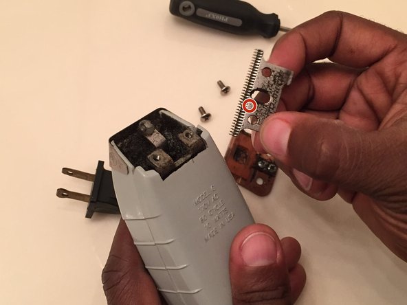

  4. Andis T Outliner Trimmer with T Blade Model G Top Blade Replacement, Remove bottom blade from top blade.: crwdns2935265:04crwdnd2935265:01crwdnd2935265:02crwdne2935265:0 Andis T Outliner Trimmer with T Blade Model G Top Blade Replacement, Remove bottom blade from top blade.: crwdns2935265:04crwdnd2935265:02crwdnd2935265:02crwdne2935265:0
    • Flip the top blade over.
    • Lift the bottom blade from the top blade.
  5. Andis T Outliner Trimmer with T Blade Model G Top Blade Replacement, Clean and lubricate the device if necessary.: crwdns2935265:05crwdnd2935265:01crwdnd2935265:02crwdne2935265:0 Andis T Outliner Trimmer with T Blade Model G Top Blade Replacement, Clean and lubricate the device if necessary.: crwdns2935265:05crwdnd2935265:02crwdnd2935265:02crwdne2935265:0
    • Clean or lubricate the device if necessary.
