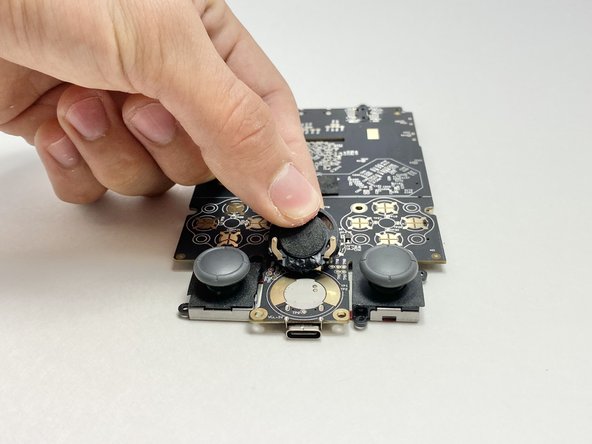

  4. Anbernic RG353V Speaker Replacement: crwdns2935265:04crwdnd2935265:01crwdnd2935265:02crwdne2935265:0 Anbernic RG353V Speaker Replacement: crwdns2935265:04crwdnd2935265:02crwdnd2935265:02crwdne2935265:0
    • Use a Phillips #00 to remove the four 6 mm screws attaching the thumbsticks to the circuit board.
    • Use a spudger to flip up the locking flaps of the ZIF connectors.
    • Use tweezers or your fingers to gently pull the red ribbon cables out of their sockets.

  6. Anbernic RG353V Speaker Replacement: crwdns2935265:06crwdnd2935265:01crwdnd2935265:02crwdne2935265:0 Anbernic RG353V Speaker Replacement: crwdns2935265:06crwdnd2935265:02crwdnd2935265:02crwdne2935265:0
    • Use a Phillips #00 screwdriver to remove the four 5 mm screws that secure the circuit board to the case.
  7. Anbernic RG353V Speaker Replacement: crwdns2935265:07crwdnd2935265:01crwdnd2935265:01crwdne2935265:0
    • Carefully remove the circuit board by pulling it upward and away from the case.
    • Gently thread the two ribbon cables through the slot to avoid damage.
