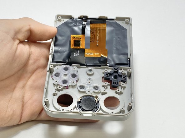

  8. Anbernic RG353V D-Pad Button Replacement, D-Pad Button: crwdns2935265:08crwdnd2935265:01crwdnd2935265:02crwdne2935265:0 Anbernic RG353V D-Pad Button Replacement, D-Pad Button: crwdns2935265:08crwdnd2935265:02crwdnd2935265:02crwdne2935265:0
    • Peel off the D-pad button cover.
    • Push out the old D-Pad button from the front of the case.
