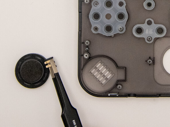

  7. Anbernic RG 40XXV Speaker Replacement, Speaker: crwdns2935265:07crwdnd2935265:01crwdnd2935265:02crwdne2935265:0 Anbernic RG 40XXV Speaker Replacement, Speaker: crwdns2935265:07crwdnd2935265:02crwdnd2935265:02crwdne2935265:0
    • Using ESD-safe tweezers, gently pull the speaker out of the case.
    • Using ESD-safe tweezers will prevent further damage to your device or harm to yourself.
