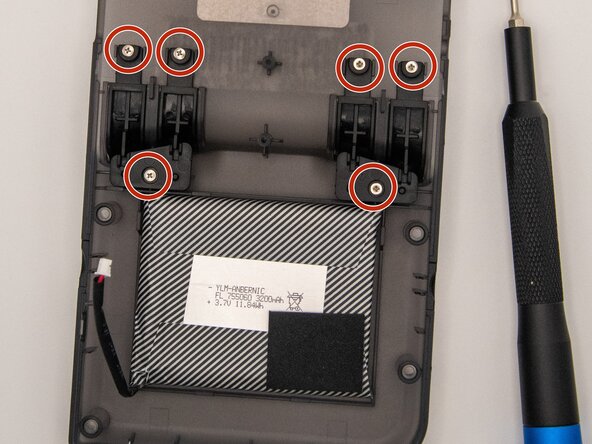

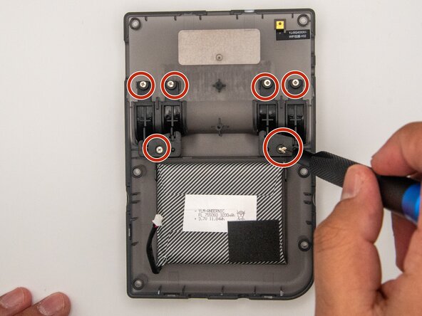

  4. Anbernic RG 40XXV Shoulder Button Replacement, Shoulder Button: crwdns2935265:04crwdnd2935265:01crwdnd2935265:03crwdne2935265:0 Anbernic RG 40XXV Shoulder Button Replacement, Shoulder Button: crwdns2935265:04crwdnd2935265:02crwdnd2935265:03crwdne2935265:0 Anbernic RG 40XXV Shoulder Button Replacement, Shoulder Button: crwdns2935265:04crwdnd2935265:03crwdnd2935265:03crwdne2935265:0
    • Using a Phillips #000 screwdriver, unscrew the six 5 mm screws holding the shoulder buttons in place.

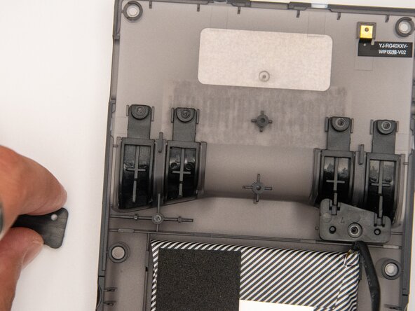

  5. Anbernic RG 40XXV Shoulder Button Replacement: crwdns2935265:05crwdnd2935265:01crwdnd2935265:02crwdne2935265:0 Anbernic RG 40XXV Shoulder Button Replacement: crwdns2935265:05crwdnd2935265:02crwdnd2935265:02crwdne2935265:0
    • Use a pair of ESD-safe tweezers to remove the covers holding the shoulder buttons in place.
    • Place the shoulder button covers to the side to allow easy accessibility to the shoulder buttons for replacement.

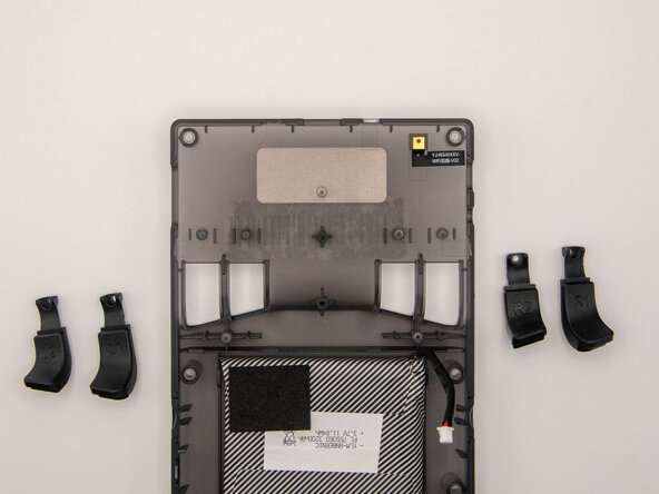

  6. Anbernic RG 40XXV Shoulder Button Replacement: crwdns2935265:06crwdnd2935265:01crwdnd2935265:02crwdne2935265:0 Anbernic RG 40XXV Shoulder Button Replacement: crwdns2935265:06crwdnd2935265:02crwdnd2935265:02crwdne2935265:0
    • After removing the covers from the shoulder buttons, pull the buttons out. They will easily dislodge from the back of the case.
