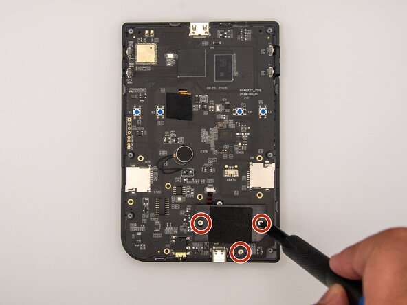

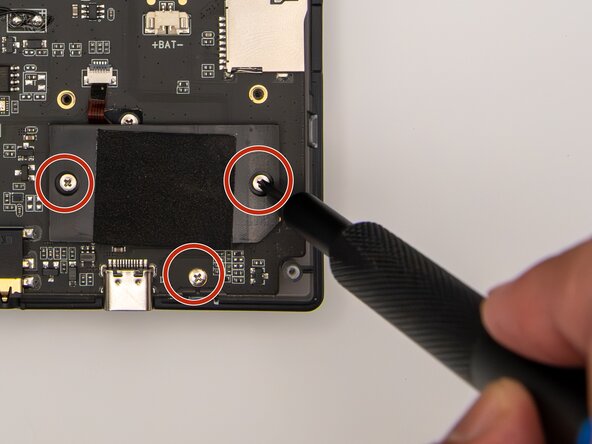

  4. Anbernic RG 40XXV Screen Replacement, Motherboard: crwdns2935265:04crwdnd2935265:01crwdnd2935265:03crwdne2935265:0 Anbernic RG 40XXV Screen Replacement, Motherboard: crwdns2935265:04crwdnd2935265:02crwdnd2935265:03crwdne2935265:0 Anbernic RG 40XXV Screen Replacement, Motherboard: crwdns2935265:04crwdnd2935265:03crwdnd2935265:03crwdne2935265:0
    • Using a Phillips #00 screwdriver, remove the 10 5.5 mm screws securing the circuit board to the case.

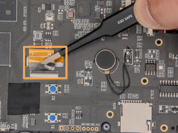

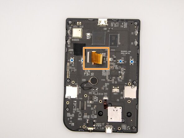

  5. Anbernic RG 40XXV Screen Replacement: crwdns2935265:05crwdnd2935265:01crwdnd2935265:03crwdne2935265:0 Anbernic RG 40XXV Screen Replacement: crwdns2935265:05crwdnd2935265:02crwdnd2935265:03crwdne2935265:0 Anbernic RG 40XXV Screen Replacement: crwdns2935265:05crwdnd2935265:03crwdnd2935265:03crwdne2935265:0
    • Remove the tape covering the ribbon cables.
    • Using ESD-safe tweezers, gently pull the ribbon cables away from the circuit board.
    • Using ESD-safe tweezers will prevent further damage to your device and harm to yourself.
  6. Anbernic RG 40XXV Screen Replacement: crwdns2935265:06crwdnd2935265:01crwdnd2935265:01crwdne2935265:0
    • Gently lift the circuit board out of the case.

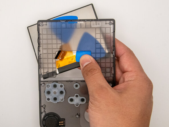

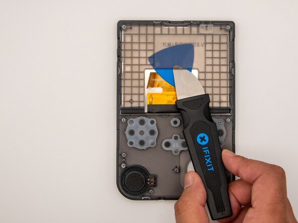

  7. Anbernic RG 40XXV Screen Replacement, Screen: crwdns2935265:07crwdnd2935265:01crwdnd2935265:01crwdne2935265:0
    • Gently slide an opening pick in between the screen and the case frame.
    • Do not slide the opening pick under the case frame aggressively, as this could damage your screen or device further.

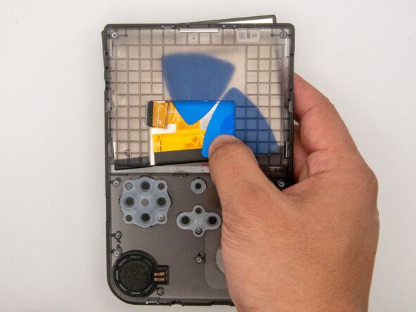

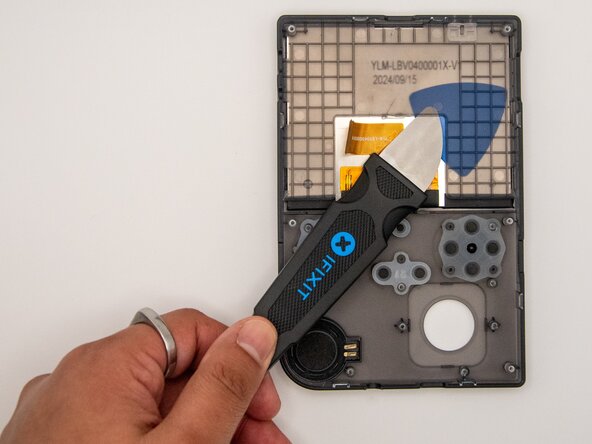

  8. Anbernic RG 40XXV Screen Replacement: crwdns2935265:08crwdnd2935265:01crwdnd2935265:03crwdne2935265:0 Anbernic RG 40XXV Screen Replacement: crwdns2935265:08crwdnd2935265:02crwdnd2935265:03crwdne2935265:0 Anbernic RG 40XXV Screen Replacement: crwdns2935265:08crwdnd2935265:03crwdnd2935265:03crwdne2935265:0
    • Gently slide a Jimmy in between the screen and case frame.
    • Move the Jimmy around the underside of the case frame to loosen the adhesive holding the screen in place.
    • Gently loosening the adhesive of the screen is key in this step, as aggressive movements could damage the device further.
    • It may be helpful to slide another opening pick under the case frame to aid in releasing the strong adhesive.
  9. Anbernic RG 40XXV Screen Replacement: crwdns2935265:09crwdnd2935265:01crwdnd2935265:03crwdne2935265:0 Anbernic RG 40XXV Screen Replacement: crwdns2935265:09crwdnd2935265:02crwdnd2935265:03crwdne2935265:0 Anbernic RG 40XXV Screen Replacement: crwdns2935265:09crwdnd2935265:03crwdnd2935265:03crwdne2935265:0
    • Gently press on the back side of the screen to dislodge it from the case.
    • If the adhesive has not been fully released, return to step 6 to continue loosening it to avoid further damage to the device.
  10. Anbernic RG 40XXV Screen Replacement: crwdns2935265:010crwdnd2935265:01crwdnd2935265:01crwdne2935265:0
    • Remove the screen from the case.
